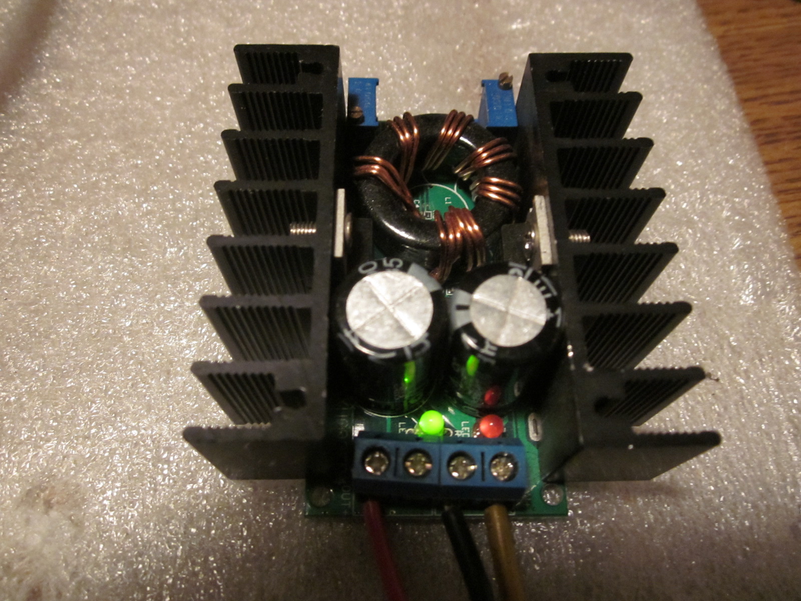

            My boost converter has two caps, one on the input and one on the output. Removing the output causes drastic change in current draw (in 3B system) and Mosfet starts to cook. Spikes or the "noise" are quite impressive - see pic below, taken across the Batt3. I bought them for different purpose and they have CV and CC pots, not just CV.

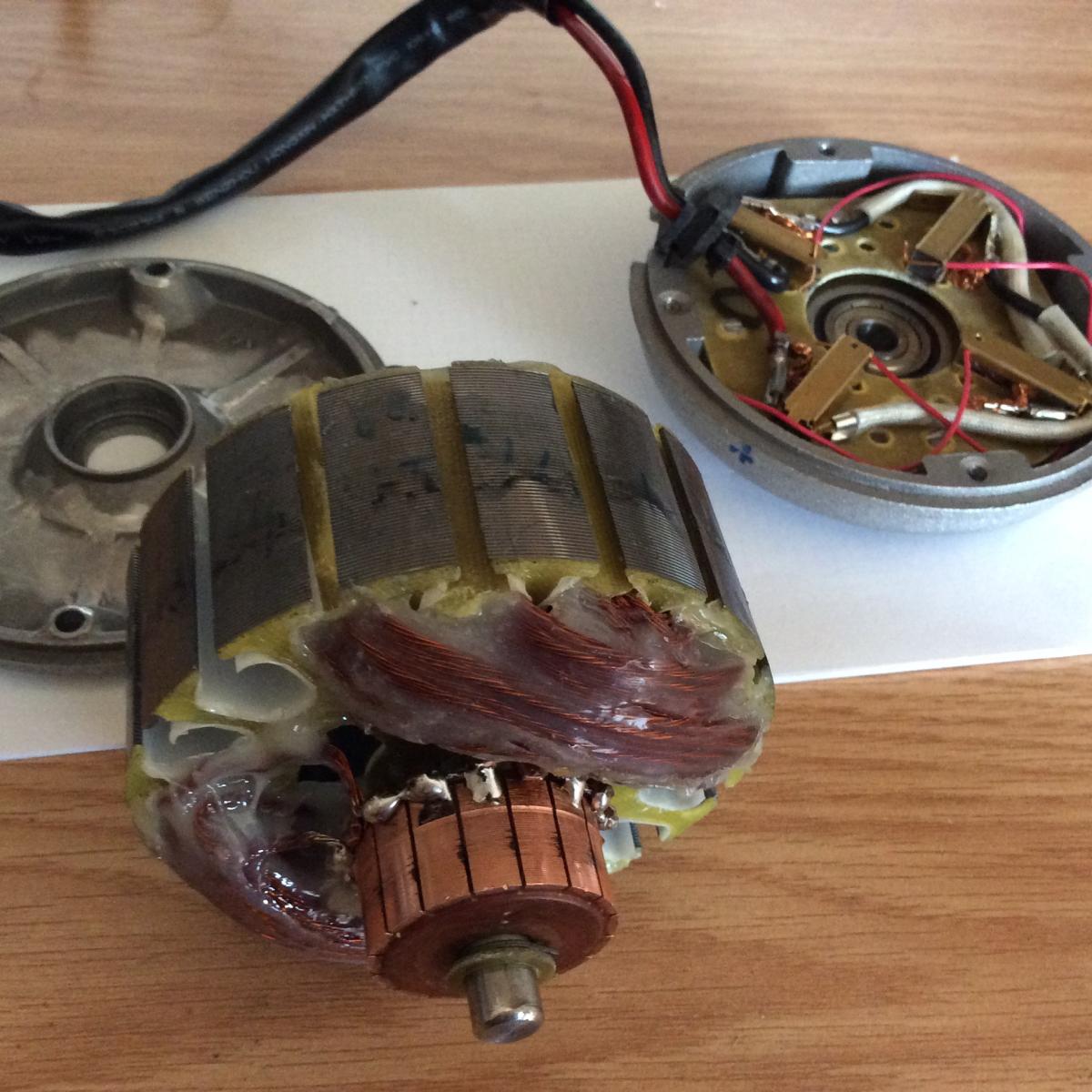

              Here is my motor ready to go.
              As it finally is becoming relevant here is my 6 years old video using two coils and magnets on ends. Switching is done manually with magnet and read switch. Spikes open voltage are in exes of 1000v. image.jpg

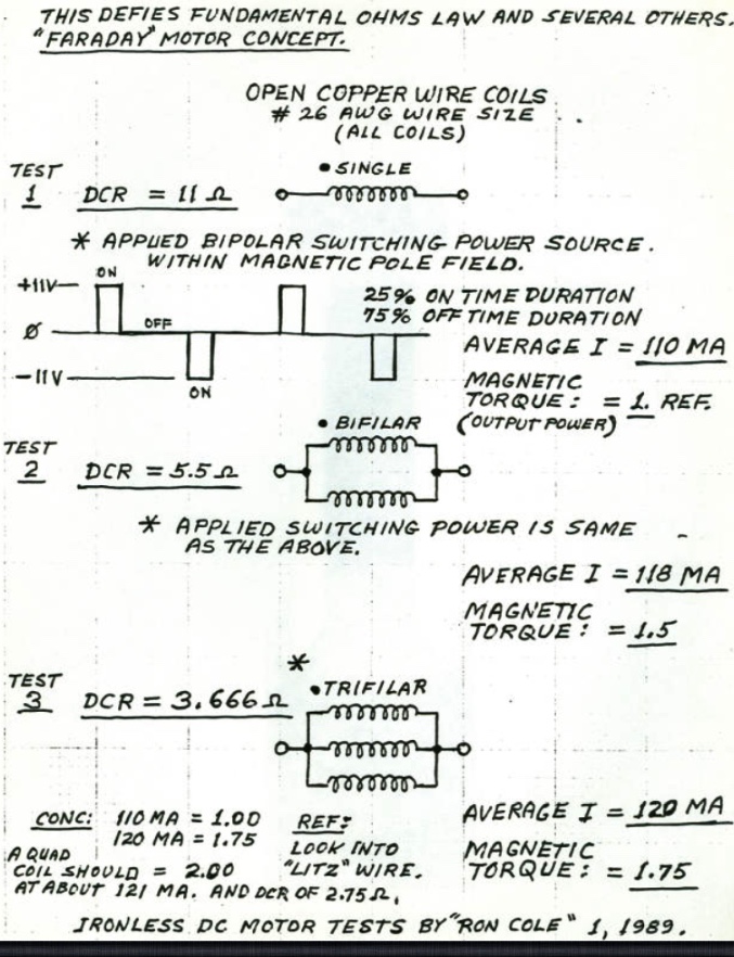

                • Multi Strand Coil Increases Magnetic Field...
                  Here is one page of Ron Coles notes, that John Bedini has shared in time past, that give some insight into multi strand coils and magnetic field strength for minimal current increase / strand.

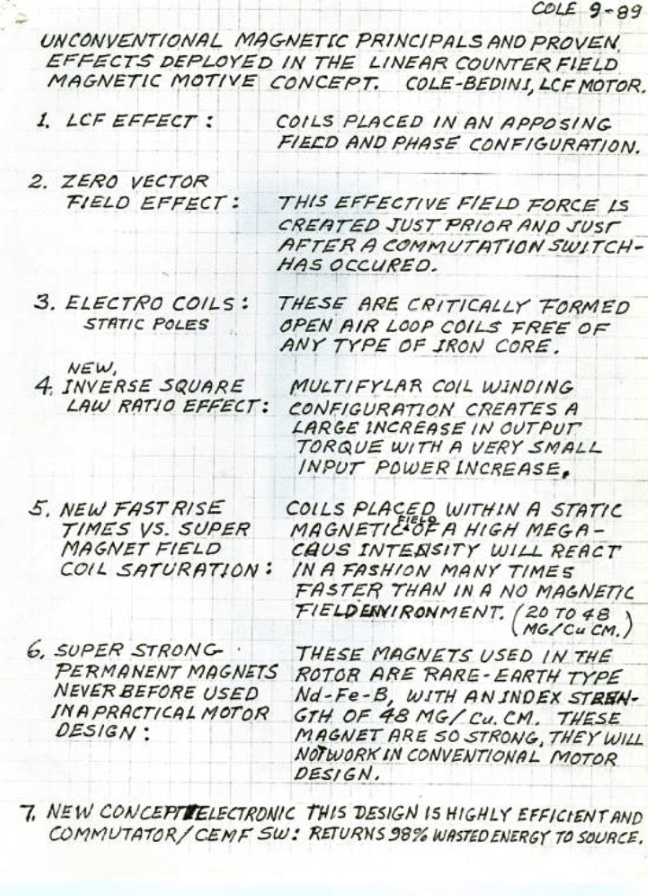

                  • Here is another...

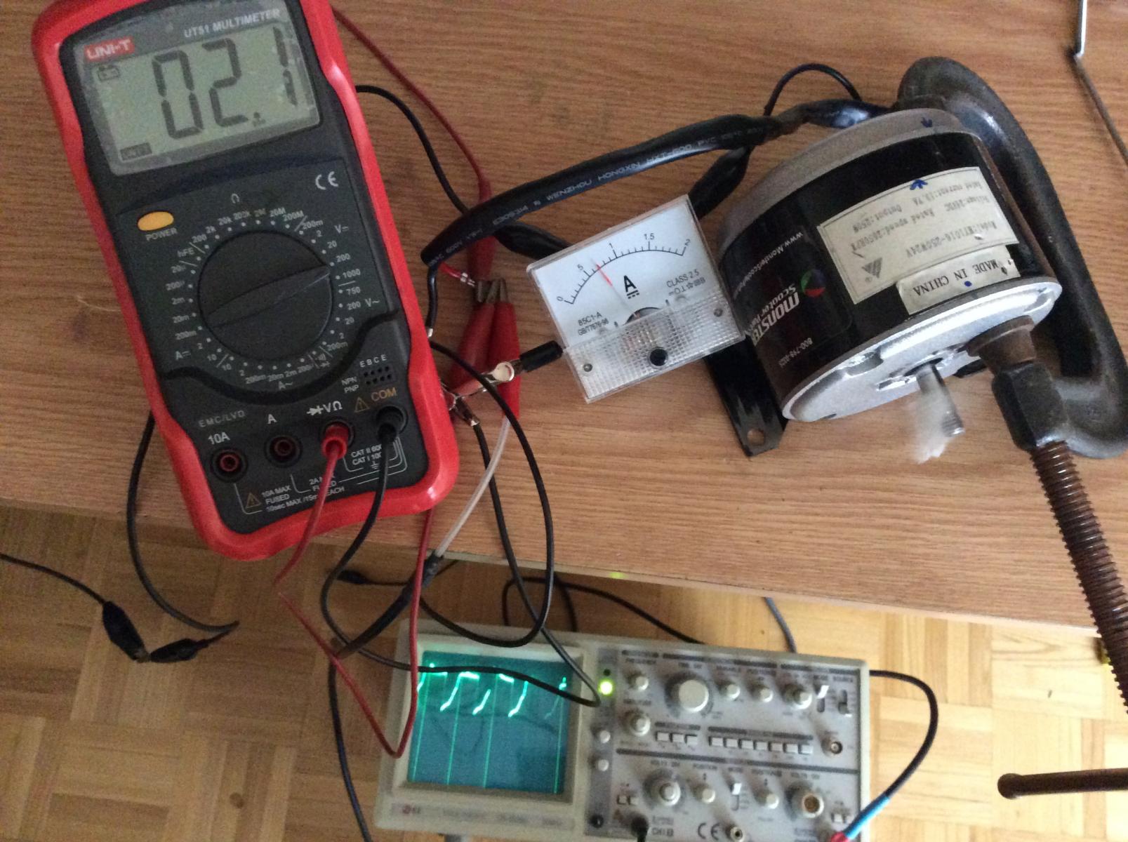

                      I like Litz wire a lot. I used 6 strands of #30 conected parallel as a twisted bundle. It is my #4 re wind. I managed to wind 80 feet of it. Considering I am only concentrating at the motor for now the latest results are realy nice. the motor runs from 2.2V up to 24v and stays cool like cucumber. At 1.3A on 12.4V tork burns fingers. If you look at the motor original markers as where normal brushes timing where. You can are see that I advanced timing frorward. I grinded the notch and rotated plate with brushes. This decreased amps from 1.7 to 1.3A and increased tork nicely. Any hint of heat was eliminated and as it is now clamped it runs stone cold. You could see on the Skope spikes are most visible on 2.1v run.

                        [ATTACH]17819[/ATTACH]
                        Thats wonderful. I appreciate the info. I am happy someone finally got a clean build out of it and was able to report the details.
                        Matt

                              At 12.7V and 1.3A it is 3600 rpm. This puppy paks some tork. As I loade it by hand it is inposible to stop. All I manage to bring it up the amps to 1.7 before my hand starts to burn.
