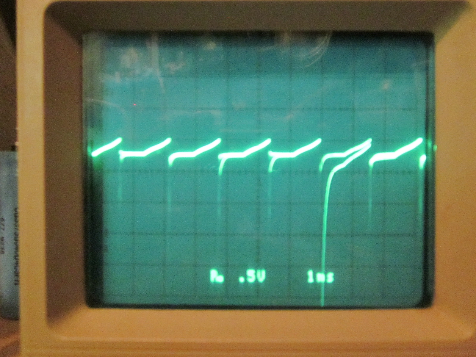

        • @Mario
          I hooked up my setup the same way as yours and probed across Batt3 with and without the diode. All those spikes which I have without are gone with diode connected from Batt3 neg. to the positive of 24V bank and the output to the load decreases. What am I missing here (beside the spikes LOL)?
          I found my freq. range with ferrite core about 650Hz is what gives best charging, highest output to the load and return to the primaries.
          Still, the load is quite small at the moment to be considered even half decent.
          More tweaking required.
          Scope shot taken across Batt3 without a diode.
          Update: never mind my comment regarding the diode. Your circuit works good. I used better diode HFA16PB120 and increased the load which gives better return to the primary batt's. Also, went back to iron core and adjusted freq to 250Hz which gives higher output to the load. I paralleled both secondary windings so there is a 1:1 ratio between primaries and secondary. This also slightly increased output to the load (16W LED array). I'll keep working on it as there is probably much more to improve.

          • V, I think with diode you don't see the spikes because they're absorbed by the battery. Using the same switching with a solid state SG circuit, the spikes I see across the switching device are quite higher with regards to having it this way, so it must be the setup, but they are still there.
            Be careful not to blow your device if you run it without diode, lol!
            Mario
            • Originally posted by Mario View Post
              Mario
              Hi Mario,
              Yes, you're right. I was just curious why they manifest on large scale without the diode. My load was brighter too. With a diode they're funneled in one direction, instead of bouncing all over the place. Easy to get something fried.
              Those spikes are quite big and I had to scroll my scope view to see their tops, despite x10 probe. I still need to find at least one more large battery as my fourth is much smaller than the rest.

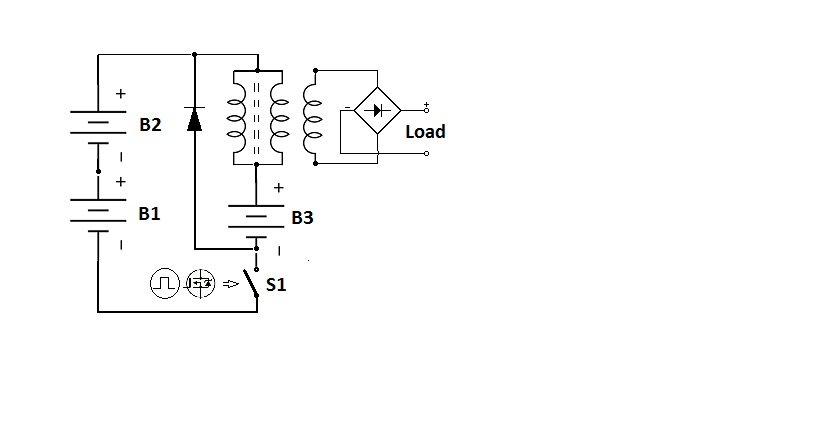

                  • Originally posted by Sawt2 View Post
                    V
                    Not sure on how it would work with Mario's 3 coil setup, but if you have an idea of how to do it.I would encourage you to go with your persistent thought and give it a try.
                    Hi Sawt2,
                    I just re drew Mario's circuit, where S1 represents a switch, either solid state (Mosfet triggered from external pulse generator) or mechanical - commutator/slip rings etc.
                    Mechanical switching has an advantage of very sharp/abrupt rise and fall with many consequences, when comes to harmonics content and collapsing field. This type of switching as well as a spark gap in hv oscillators are hard to mimic with even state of the art semiconductors, due to their internal resistance, delays etc.
                    V

                    • Originally posted by blackchisel97 View Post
                      Hi Sawt2,
                      V
                      Thats not really the truth. That might be the state of individual skills but still that is not the truth when it comes to Fets and IGBT's. Most new ones have the same resistance and voltage drop as couple of feet of wire. LOL and ya'll are winding these coils with plenty of that.
                      Lag in timing is more to do with the inductor (Coil) than anything and mechanical switching will not change that. Its all math. You wanna big transient spike don't saturate the coil. You want to transform current then you saturate. No matter what you want, Frequency and duty cycle will play a role. How you switch isn't as near important as the capacity of the coil to achieve a certain output.
                      Thats what has amazed me about this newest setup. What are you really doing? Your using a crude boost circuit. Thats it. Take one them boost circuits we were buying and pull the smoothing caps off of it. 200 khz of spikes flying out of that thing and probably at a better efficiency. LOL
                      Here, you want some guidance, Measure your coil for henry, then change the numbers in this calculator till you get what you have in the inductor. Now you have the best your gonna get. You can build communtator or use cheap FET and skip the smoothing caps.
                      For many small projects, its cheaper and easier to DIY a boost converter than to buy a specialty chip. DIY converters are usually not as efficient but they're quick & cheap!
                      If you can't use micro controller or refuse to try then go with a 555. Here is that calculator.
                      555 (NE555) Astable Circuit Calculator
                      Even if you decide to ignore all this please do not act like we live in the early 80's and we have to fight tooth and nail just to drive a simple semi conductor. Take the time to learn how to use a semi conductor as a switch...
                      Matt
                      • Matt,
                        I just shared and idea, nothing else. As I said, it may or may not matter in this setup how we switch and your points regarding coil parameters as well as freq and duty cycle are indisputable.
                        I can calculate 555 in my head but thank you for the link on boost calculator
                        What am I doing wrong with switching Fet's?
                          Matt,
                          V
                          I don't know what your doing wrong... How could I? But if your under the opinion that Fets cannot produce strong on off signals then you must be doing something wrong. I am sure mechanical can do just as much but the dynamic ability to adjust is just not there.
                          I was just bothered by the statement that semi conductors are somehow inferior, do to delay time and voltage drop, which almost don't exist anymore in a modern semi conductor.
                          Just my opinion,But a good mosfet switch outperforms a mechanical switch every day of the week just because of its ability to be adjusted quickly.
                          Matt

                                Ok, that's the beauty of online communication vs live one.
                                I thought, you have a problem with my posted diagram and the side/way of switching... sending me back to study 555 and semiconductor theory .
                                What about the noise/harmonics content? Certainly, we won't get that in solid state but is this something that matters here, in your (or anybody else) opinion?
                                Again, just asking about this particular setup, not in general as I know the answers for different other applications. .
