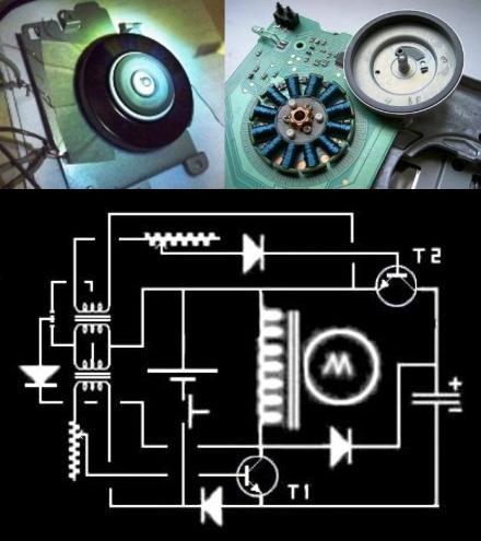

hi matt.hi all. i couldn't view your last circuit. so i tried a circuit to suit bifilar wound brushless motor coils that feeds the recovery back in as you describe. it's based on my usual j.t scheme. it only powers half the turns in a motor, tho you could probably get away with 2/3 or 3/4 powered and the rest for recovery. the transistor could be switched by other means.
Pic 1 works with an unloaded bifilar wound rc motor. hooked up to a smps with reg. 12.0v output and a 39000 uf cap for smoothing and the dmm between the supply and the big cap, with s1 open, tuning vr1 for max rpm, current is 610 ma. s1 closed,tuned for max rpm is 410 ma. the transistor is switched by a mini isolation transformer rated at 3k:3k reactance, i usually use 40 v 1 a 1n5819 diodes, (in parallel for more current).they measure about .17 v drop. they are a little bit leaky backwards,but usually beneficial to the bottom line in these schemes, and they have higher rated schottky cousins with similar numbers. c1 is 100uf low esr. tip 122 and vr1 is a 100k lin pot.curiously the current doesn't increase when i load the motor by pinching the shaft until it is nearly stalled in either mode.?? i would expect the shorter the pulse,the more efficient this gets, rapid pulses with a high duty cycle, during every power stroke, would go better.
i'm also workin on a circuit to pulse a standard brushed motor. i got a brushed pancake motor to play with. the rotor has coreless windings, which can handle a very rapid pulse rate, smps frequencies, and still kick back.
pic 3 works with the pancake motor. when being pulsed, max v on c1, with t2's collector disconnected is 120v, current draw at max rpm is 870 ma. with t2's collector connected, (after discharging c1), the current draw at max rpm is 700 ma. that's only about 20% off. motors with iron cored windings will kick back harder than air cored windings, but there's another issue with standard brushed motors. generator effect bemf is going against the spike output. it's like throwing a frisbee into a stiff breeze. a brushless or matt modified brushed motor is at or near the zero crossing point at switch off, so minimal bemf/opposition to the spike energy.
it took me a while to figure this circuit out. without the diode with the yellow dot the motor power supply goes through the j.t. and holds t1 on. go figure. i use a fr302 for this 1 to avoid any back leakage. the j.t has a bc 547. anything with a built in diode can't be tuned properly. deleting the 2 diodes at the emitter of the 547 will smoke t2. the collapsing field spike is in series with the battery which closes the loop to charge c1. now 470 uf. and the same pathway maintains c1 at a minimum of input v - diode drops. no heat sink is needed on t2 in this case. splitting the signal source for t1 and t2 makes it easier to tune. i think the upper tap is more conducive to switching t1 off last, so the spikes don't get wasted in the event that t2 switches off last. i found i can optimize the base resistances, with 100k pots, so that each tip flows the right amount of current, with the right timing, then replace it with the right fixed resistance. tuning is adjusting t1's signal so it flows all of the current the motor can take, without staying on, and setting t2's signal so that c1's voltage is at or a bit over input v. much over means turn up the signal to t2's base, but still have it switch off first.
pic 5 is a variation of pic 3 hooked up to 1 phase of a brushless floppy drive motor. there are 16 alternating poles in the motor hub. so the transistors are on for about a 16th of a rotation, then off for a similar period. the frequency measures around 680-700 hz at max rpm,a bit under 5000, so 1 on period is about 1/1400th of a sec, about .7 of a millisecond. more signal strength might go better. it needs darlington transistors to fully switch the current. on something homebuilt with 400 turn coils and neo magnets there would be more than adequate signal strength.
pic 6 is another scheme hooked up to the floppy disc motor. the power supply provides the base current to the 2nd stage npn and pnp. 3 bright white leds and 4.3k set the signal strength. dcr is 2.8 ohms/ phase. the 2nd stage transistors have to switch off at the exact same instant, or the spike energy will be shorted and lost. this scheme might be close to what your already doing, based on your description.
** ok, with pic 6 hooked up to 2 phases,input current is 115 ma,recovered/recycled power is 32 ma, motor consumption is 147 ma, just under 22 % back. better than 6-7% back on 1 phase, but a long way short of getting the majority back. and flash caps are the most efficient for c1, 300 uf here.
I never thought of, or tried feeding the recovered power back in to a motor like this until you spelled it out in post 1592. pretty basic, but sounds like a great plan. you guys probably already know this stuff, but i thought it was worth posting. nice gen dave.
