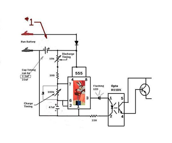

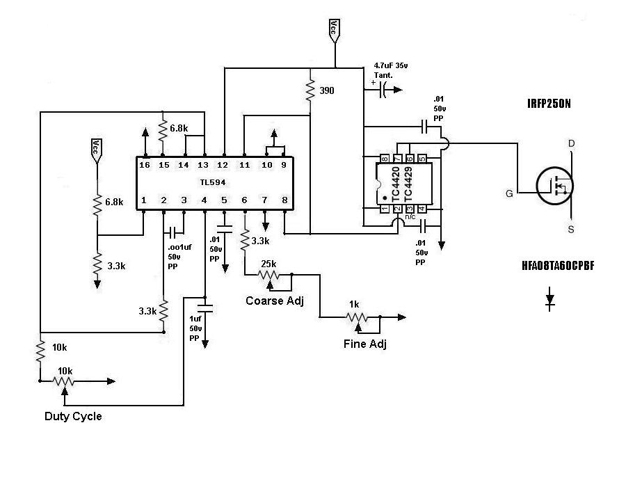

Okay Group Members I need to ask this.
Why would someone use 1000 ohms on the gate when 10,000 ohms opens the gate fully? Unless they were using a lower voltage? I mean some guys are using the same circuit and charging the same 36vdc battery packs and yet showing a 220 ohm gate resistance for fet irfp260.
The question I have is if 1000 ohms opens the gate fully and 10,000 ohms opens the gate fully won't the higher ohm resistor be easier on the fet and make it last longer?
Thanks again to all.

Yes big big inrush amps enough to blow the sulfation right of a huge battery plate.
