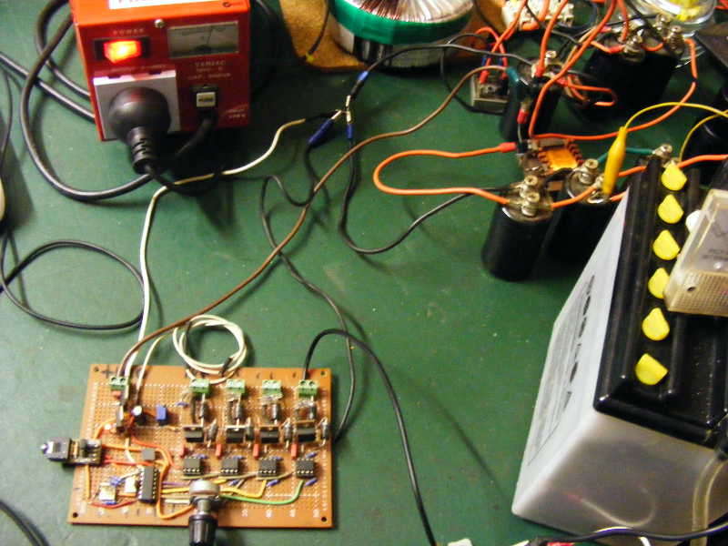

              I am back with an update that my transistor blew up Remember I have six of them? I am running extreme power into of surging voltages and amp fluctuation plus 100 degree heat in the room.
              No mercy, 100vdc input at 7-12 amp fluctuating on input side. 3 ohm resistor to run all of the power through to the cap bank.
              Output side 35 amp pulses 3 times per second.
              3 Days later one FET is shorted.
              Fet temps were 125 degrees for 3 days.

              I am passing 35 amp pulses using 6 parallel IRFP460 FETS.
              This divided up evenly = 6 amps per FET and since each Fet is also passing voltage with it we must multiple 80vdc X 6 Amps = 480 watts in 250 mS. That is 480 watts EACH so X 6 =2800 watts.
              So we can C that my poor little darlins are smoking da junctions cause I didn't do the math

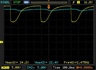

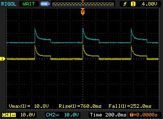

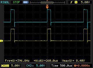

                          • I've been busy making some shots and pictures for you, I'll go back and read
                            the posts I missed soon.
                            Here below is a circuit I tried tonight, I used 26 volts dumped in a 250 mS
                            dump time with 500 mS recharge for the dump caps. The 45,000 uF caps had
                            not fully discharged in 250 mS, There was still about 2 volts and some current
                            when the mosfet turned off.
                            I got about 13 Amps peak current on dumping that declines. The current
                            sense resistor is 0.8 Ohms and it got hot but the mosfet stayed cool to the
                            touch. Maybe if you put a 0.5 Ohm resistor in series with the mosfets Sources
                            it might help.
                            Also
                            Shot 1) is the wave form of the applied voltage in blue and current yellow. Note
                            the voltage scale and the yellow voltage is divided by 0.8 to get amps through the battery.
                            Shot 2) is the voltage on the supply caps and the dump caps. Note the dump
                            caps drop voltage and this reduces the current a lot before switch off.
                            Shot 3) is my gate wave form taken on the gate while working.
                            Shot 4) is the fall time of the gate voltage. This allows the turn off with
                            current still flowing without excessive heating, because the cap was not fully discharged.
                            This indicates 2 Ohms resistance in the discharge path, if I took out the 0.8 Ohms
                            current sense resistor the peak current would be more like 21 Amperes. I think
                            P.S. If I put my ear near the wire to or from the battery or near the mosfet I
                            can hear an audible tick....tick....tick in the mosfet and wires, it sounds like a
                            spark plug sparking, but it is a good sound, the sound of shock and awe,
                            If I was to scope different parts of the wires I would see ringing at HF probably.
                            In cicuits that switch randomly like my solar circuit the clicking sound becomes a jittering buzz,
                            like a code or logic language.
                            2nd P.S We can see by the initial voltage and the initial current on discharge
                            that 26 volts x 13 amperes = 338 Watts applied initially to the battery, but
                            declining, the circuit is drawing a fluctuating power of between 25 and 65 Watts from the wall socket.
                            Actually, maybe the battery voltage needs to be subtracted from the 26 volts cap voltage for some calculations.
                            And the coil I used with 2.7 Ohms resistance got real hot so need more
                            inductance and less resistance in the coil, maybe a MOT primary would work.

                              Pretty tricky Farmhand
                              I am learning something new putting in coils of high wattage in the place you show. Now I get it so the heat goes to the coil and not the MOSFET.
                              Nice waveforms, lots of good work, what a man. So this way a coil could save the FETS. Plus a coil done right won't burn the energy just slow if and store it. Humm....? I don't know.
                              You have got the wheels turning. I like the looks of your driver board.
                              My input is 1000 watts. I charge my cap bank to 100vdc and 3 pulses per second empties the bank beginning at 65-70vdc and down to 36vdc so I am operating so fast it is like an always "ON" condition. Very little rest interval. 3 pulses dumping with each pulse taking 300mS to discharge so 50mS charge up time.
                              Me bee smokin dem fets
                              Waveform 1-4 is very interesting. I am glad to see these because I am not sure how to do it over here.
                              Mike
                              • yeah you got it, kinda, the coils inductance slows the flow of current from the
                                supply to the dump caps, I'm using smoothing caps because I 'm using a
                                transformer, I can't setup a large setup like yours but I can set up a smaller version.
                                So with the right coil between the supply and the dump caps and the right
                                "on" time and "off" time we should be able to get down to almost zero current
                                at switch off due to the coil storing the energy and causing the dump cap to
                                drop voltage without drawing directly from the supply during the dump time,
                                the dump caps fill when the switch is off because the coils "momentum"
                                causes it to discharge into the dump caps due to the switch turning off.
                                The intention isn't to heat up the coil or anything and a coil with less
                                resistance but a with the appropriate inductance is better.
                                I'm now using a microwave oven transformer primary, and with 30,000 uF I
                                can get the cap to fully discharge in around 70 mS or less which leads to an
                                almost no current situation at switch off. it takes about 350 mS to recharge
                                the cap and it goes to a slightly higher voltage due to the storage of energy
                                in the big coil. The peak current is the same if the voltage is the same and
                                the resistance of the current path on discharge is the same. This is a way to
                                isolate the supply from the load during the dump without using a second
                                switch "except for the diode".
                                I'll include some shots of the action of the voltage on the caps in that mode.
                                as well as a shot of the applied voltage and resulting current when the
                                discharge is short and the capacitor does not get fully discharged.

                                The first shot shows the supply capacitor voltage in blue and the dump cap
                                voltage in yellow, as the mosfet turns on the dump cap discharges but no
                                current flows directly from the supply to the load due to the coil causing a
                                delay and storing energy, which is released when the mosfet turns off.
                                Second shot shows the applied voltage and resultant current when the
                                mosfet is switched on and off before the cap can discharge, this requires a
                                fast turn off to do without excessive heating of the switch.
                                This shot shows the circuit working at 400 Hz and pulsing the battery with 10 Amp
                                rectangles of current for 260 uS, it's 400 Hz 10% duty, That really pumped up the battery.
