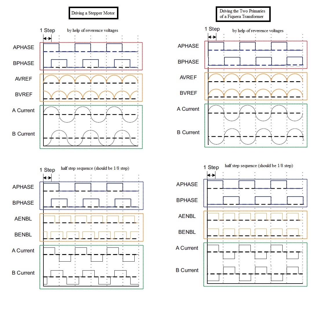

@Wonju:
The SureStep (microstepping drive) http://www.automationdirect.com/stat...estepdrive.pdf is a real beauty. This is what they used when I came up with the LMD18245 in the 1990ies. Now is the time of the ICs for a fraction of the cost.
For high Wattage one still has to use these cumbersome boxes.
But yes, the SureStep will do, but is it really worth while to spend the money? I advise against becoming too serious when doing OU experiments.
I will go for the "DRV8834 plus SMD adapter board" in connection with a LaunchPad carrying a MSP430G2452 microcontroller. That stays will below 50 Euro.
To solder that together will cause some anxious fiddling, but what the hell, it is only a hobby.
Greetings, Conrad
