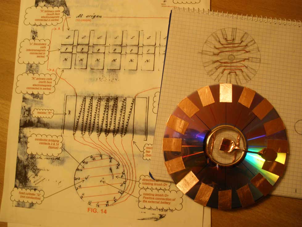

    for myself i tried some approach of the system
    here some pix of my preparation of a replication
    first pix are an idea to build the round tap system (not tested yet )

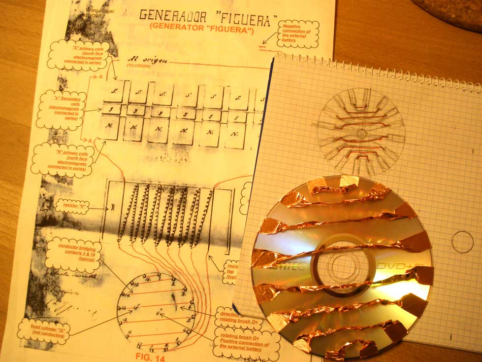

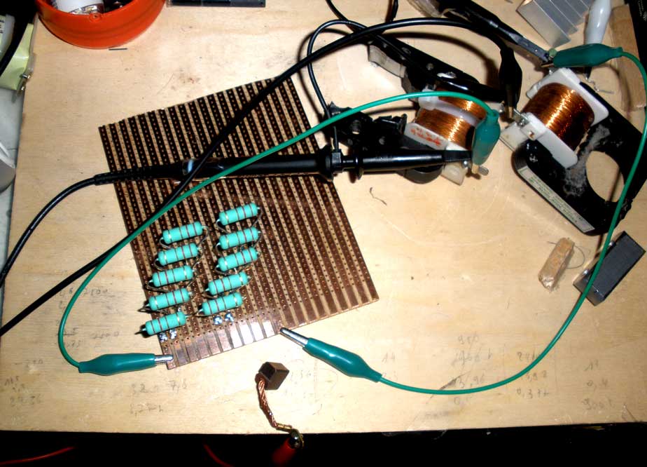

    So as you can see (pix 3 ) , i have made a serial of 2.2 k ohm resistor (10 time 220 ohms in serie with 10 tap connector places ) and tried to slide by hand ,back and forth a brush on the connector (red wire ).

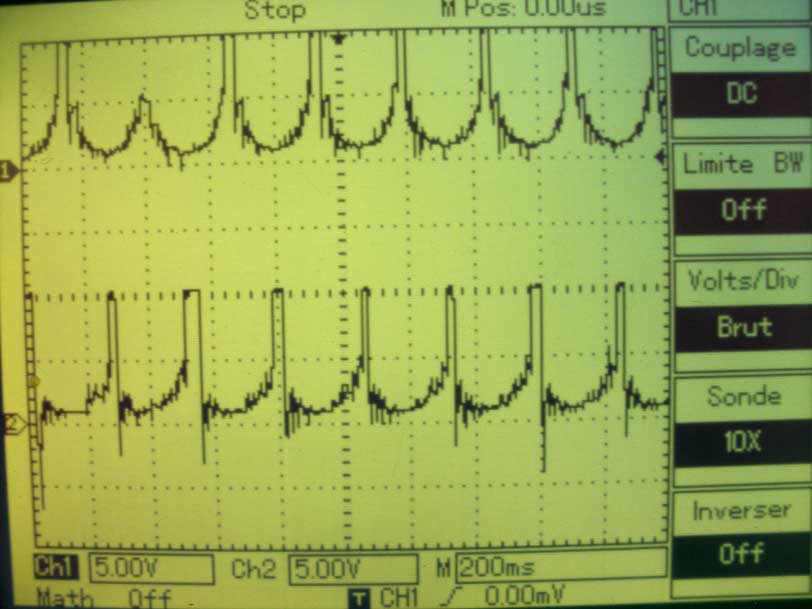

    I got very different results depending of the coils
    here for eg 2 coils with armature from a microwave oven fan motor.
    As you can see i can not get a nice u shape wave , but more an inverted u wave shape.

      I do not think the set up that you have will work satisfactorily. As soon as the brushes begin rotating, the plastic disk will not resist the friction and heat generated. If you want something reliable, you will need a commutator similar to this one:
      Commutator(Electric Power Tools) D21A - China Electronic and Digital Products Wholesale Center.
      Still, you will need to arrange for the brushes to rotate around it.

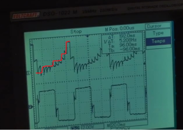

                              When stepping up and down the current through the two primary coils (in one coil the current increases, in the other coil the current decreases), should the current always return to zero between steps (which is the case when using a commutator)?
                              It is visible in Woopy's scope trace that the current returns to zero between steps (when switching through the resistors). And I indicated with a read line as it should be according to my thought (see the attached scope shot done by Woopy).
                              My thought:
                              The current in the primaries should increase/decrease continuously.
                              This can be realised by using a microprocessor
                              and a 2-Phase Motor Driver like the TCA3727 (can drive both primary coils, 6 steps = 5 resistors)
                              or two 1-Phase Motor Drivers like the LMD18245 (each LMD18245 drives one primary, 16 steps = 15 resistors).
                              In the attached data sheets see pages 13 and 19 for the LMD18245 (Quarter Step Drive with Torque Compensation) and pages 14 and 18 for the TCA3727 (mini step operation).
                              There are of course many different motor drivers and more modern ones than the ones mentioned by me (which I have by chance since some years).
                              It seems that in Wonju's Arduino project the current will also return to zero when switching through the resistors?
                              Greetings, Conrad
