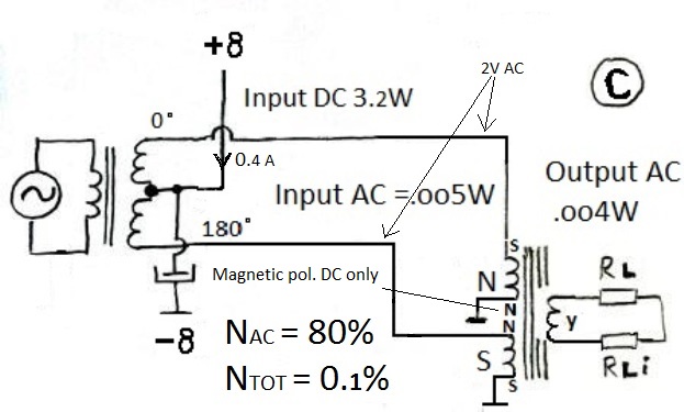

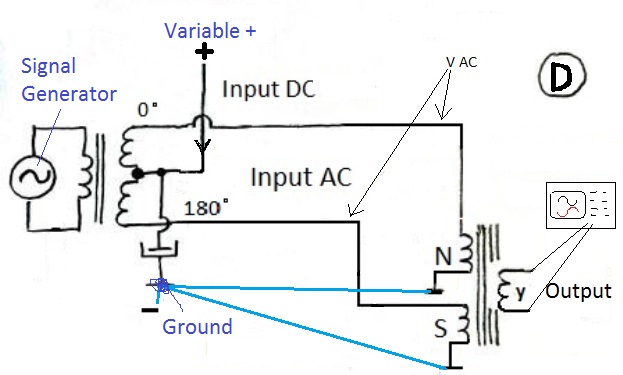

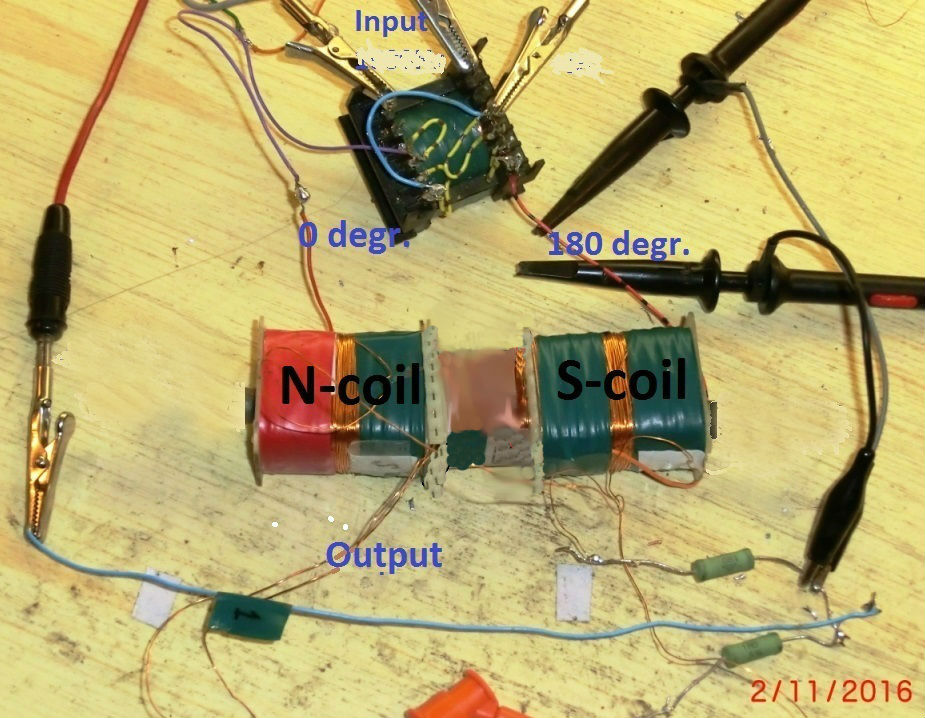

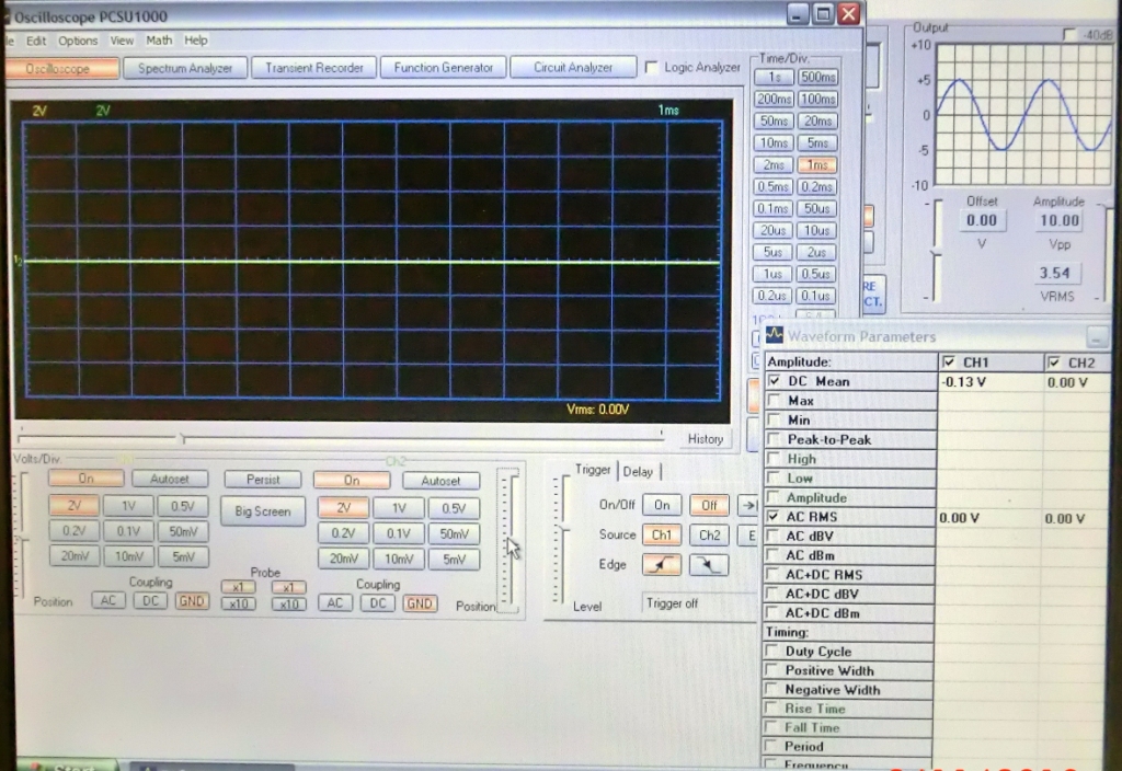

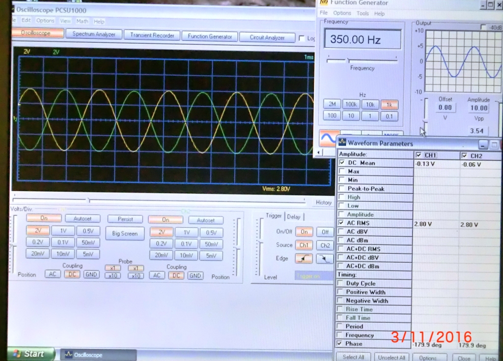

                  • Some pictures from reality. Far from OU anyhow! A Total power factor of some % is possible.
                    Pic 1) Note the input Power value DC & output Power value AC
                    Power factor AC alone about 80% !!
                    Pic 3) Zero line, Pic 4) Only AC injected Pic 5) AC and DC input (Oscilloscope pictures from input to N,S coils)
                    Regards / Arne
