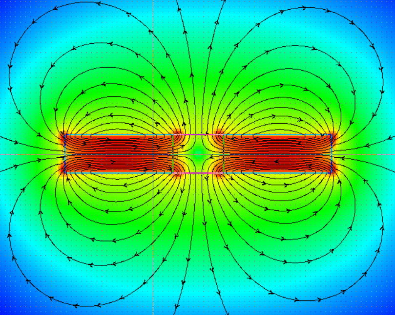

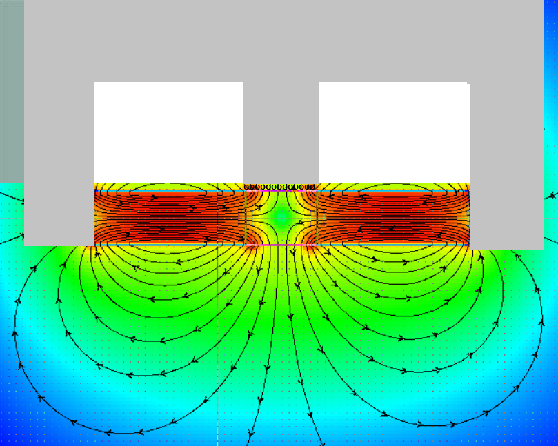

O.K. So I gave it a shot and took CM's simulation:Originally posted by bistander View PostHi hanon,
The tube you show is not what I had in mind with E-core. I'll try to get a diagram with better explanation.
And added an E-core:
Yeah, I know. Not too good with the graphics. But hopefully you can get the idea. I think to use just one section of E-core lamination stack where the cross sectional area is equal to that of the core thru the coils. This way, all the flux from each end of the core thru the coils can go thru the backiron (E-core) to the center leg and there downward thru the seconday coil turns into its core and complete its circuit. The flux lines would cut the secondary conductors at quadrature like I've been telling Ufo they do in generators. The void areas in the E-core (shown in white) represent high reluctance paths and will direct maximum flux where you want it; crossing the secondary coil.
Just an idea. Use it or lose it.

I still won't work, any metal near the secondary with a fast path to the primary will siphon off so much that you won't get a reasonable output. even the pressure between the primaries will be hard to maintain as nearly all flux will be diverted through the half E.
test it for yourself please !

I'll test it when I can be assured that the Figuera device operates as self powered O.U. energy source. At that time I'll either buy one or build one. But as of this date, I have seen no evidence that it will meet my minimum criteria.
As to your opinions of the magnetics involved with my idea of use of E-core to improve the magnetic circuit, they don't mean much to me. I don't think you know what you're talking about. I base this on past posts from you regarding magnetics. Most recently, one from the other thread. See below:
Mr. Ufo has stated enough of his design and operational parameters to do a basic calculation of the flux density in one of his primary coils. That comes out to be about 8 mT (or 0.008 Tesla). And even a cast iron core material would saturate about 0.5 Tesla. So he is about 2 orders of magnitude too low to worry about saturation.Originally posted by marathonman View PostUFOP;
