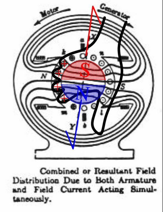

    In this image the currents in the armature conductors which you have marked with a red + are pointed out of the screen.
    In this image, the currents in the armature conductors which you marked with red + are pointed into the screen.
    So which is it? Fingers pointed with the current or fingers pointed against the current? Or any which way Ufo feels like doing today?

    Bistander,...are you wearing your prescription reading glasses?
    Have you taken your medications to relax?
    Then take another look at your same image on right, except I zoomed it for you to see better (maybe it was too small) which -according to you- is "opposite" to mine...:
    [IMG][/IMG]
    I see absolutely no discrepancies at all...according to my Right Hand Rule, now on top of your drawing, my fingers are receiving the positive as my thumb is pointing the North Pole towards where you wrote "armature labeled "Y" the North Pole"...forget about "B Fields"...all that brings you is confusione (italian)...big time.
    I am warning you, if you do not wear your prescribed reading glasses..You could end up with big headaches...
    Take care, we need you here to explain to all of Us what's coming next...

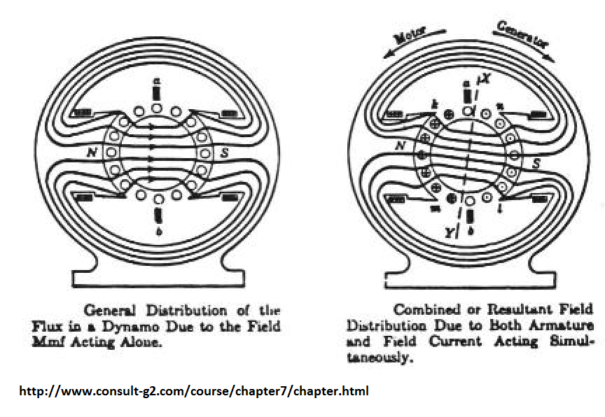

    Ufo,
    B Fields are Directional Vectors on the whole magnetic field -according to Lorentz- and so, always travel from North to South, as B Fields do not define specific magnetic polarity.
    Wrong. The B vector does define polarity. And the direction is N to S outside the source but S to N inside the source, like inside the magnet or coil. As in the diagram I attach below yours.
    [IMG][/IMG]
    Note the image on the right. The armature conductors with cross (+) are conducting current into the page (or screen). The armature conductors with the dot (.) are conducting current out of the page (or screen). The B field or B vector of the armature points downwards. That makes the side of the armature labeled Y the North pole of the armature and the upper side of the armature labeled X the South pole of the armature. This is opposite from your diagram.
    Also note the difference between the direction of rotation for motor vs generator.

    Bistander,
    Look again at that picture...
    [IMG][/IMG]
    Please take look at the spot where the positive fed wire is coming towards screen...and attaches to positive brush feeding it through commutator.
    Now look at a Right hand above DC Machine..:
    [IMG][/IMG]
    It is exactly like the image I have shown before (except this image is looking from above at machine), where positive is running toward my fingers...
    So, that image is perfectly right, it is in complete agreement with mine...so, I am correct...so many thanks Bistander!!
    At least you have found one more that agrees with me in all this hundreds of wrong images...
