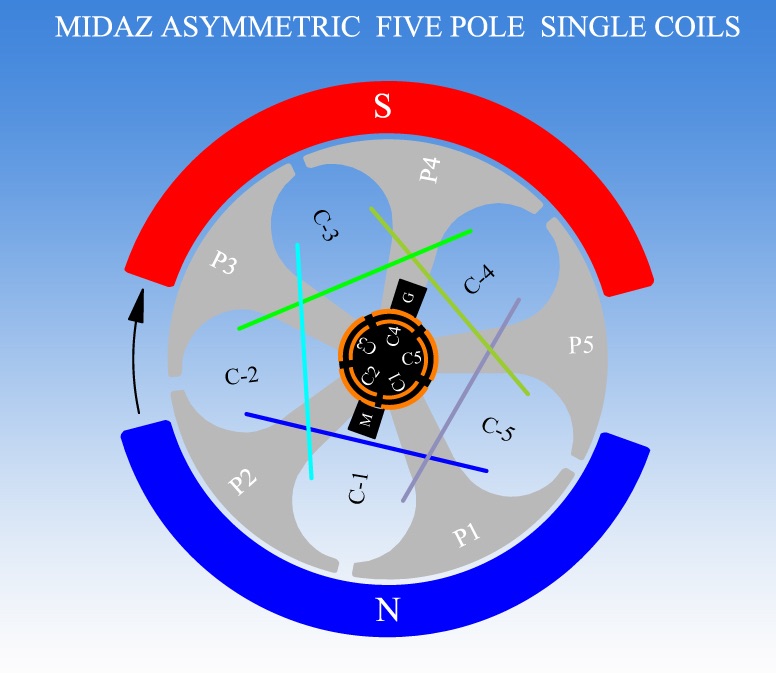

              My design is the Singular Coil that is the same size as the magnet or a little bigger than the magnet... (NOT a one pole coil, like AN3)...
              One pole coil is only for the 3pole motor/no choice .
              AN2, my design, the coil was the same size as the magnet. The singular coils covered two poles per coil.
              Keep it Clean and Green
              Midaz
              From the original image below, the singular coils are the same size as the magnet On repulsion mode... Highest TORQUE with high RPMs
              So that sounds like the single coil subtends 2 poles in AN-2 then in a 5-pole embodiment? And where are the brushes placed, like AN-3, or the thee-pole diagram?
              Thanks Midaz

                  • Originally posted by sampojo View Post
                    Thanks Midaz
                    Yes, AN-2 is "the single coil subtends 2 poles in AN-2 then in a 5-pole embodiment"... Coil is the same size as the magnet.
                    The brushes should be positioned similarly, like the original image below for MAX Torque & Rpms...
                    Then, look for a Sweet Spot/minor timing adjustment near this brush setting.
                    Welcome Sampojo
                    UFO set the image's brushes perfectly
                    • An-1 & an-2
                      Thanks Midaz
                      Hello Sam,
                      Here is a drawing with both versions of the All North Five Poles, the AN-1 (Pairs) and the AN-2 (Single Coils).
                      [IMG][/IMG]
                      AN-1 & AN-2 CHARTS TOGETHER:
                      [IMG][/IMG]
                      The Higher RPM's from the AN-1 is understood as each motor actuating circuit (Pairs) comprehends Three (3) Poles, versus Single Coils which takes Two (2) Poles...here comes the Throw Out Angle difference that I have explained before.
                      I believe Garry utilized the same amount of turns and same awg contained in the Pair, and duplicated into the Single Coil, as He did for all other replications, that is why there is no much amp draw difference between them when the sweet spot is found (green high light).
                      Here it would be very interesting to see the Torque difference or equal mechanical loads applied to both machines.
                      Hope you see it more clear now...
                      Regards Friend
