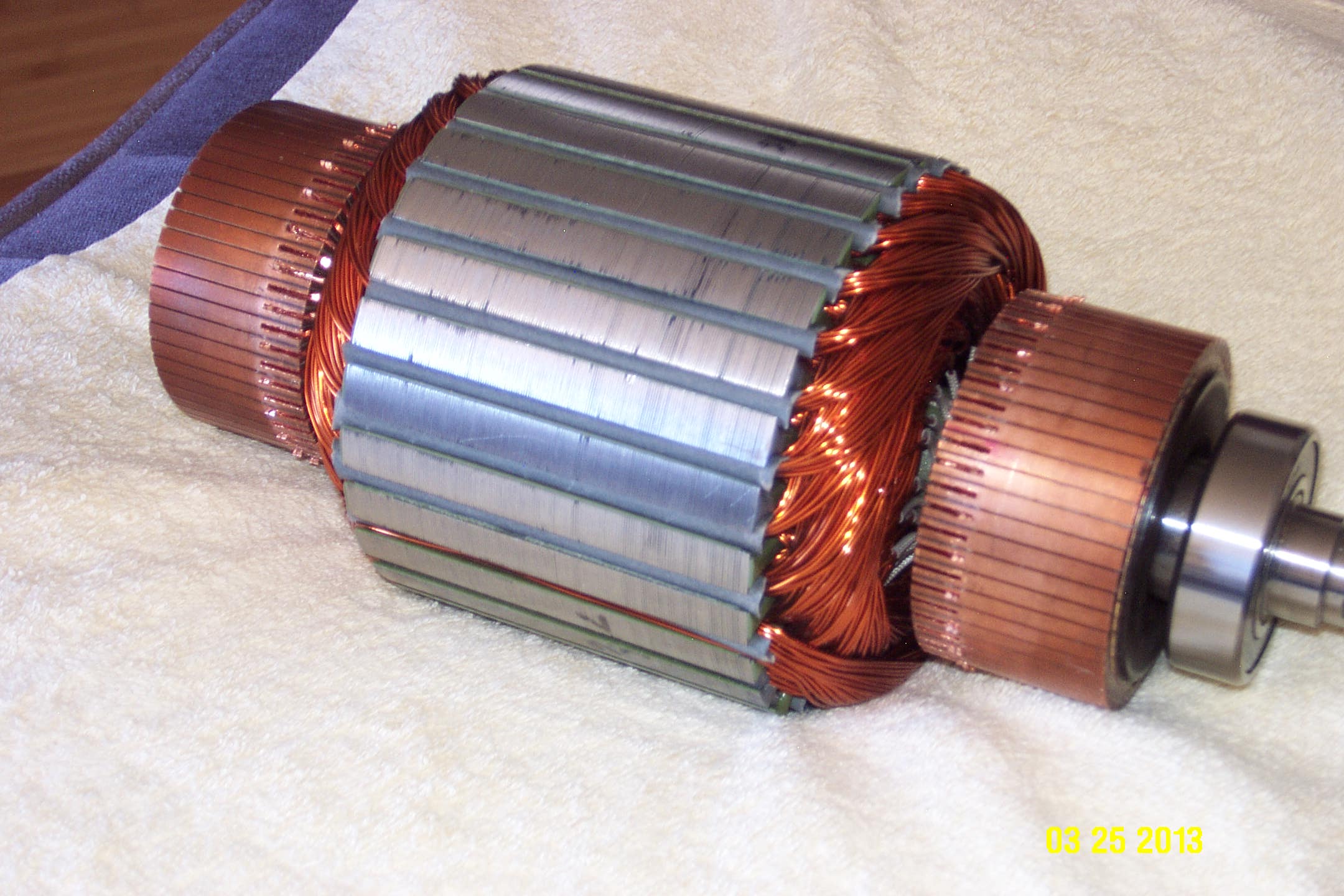

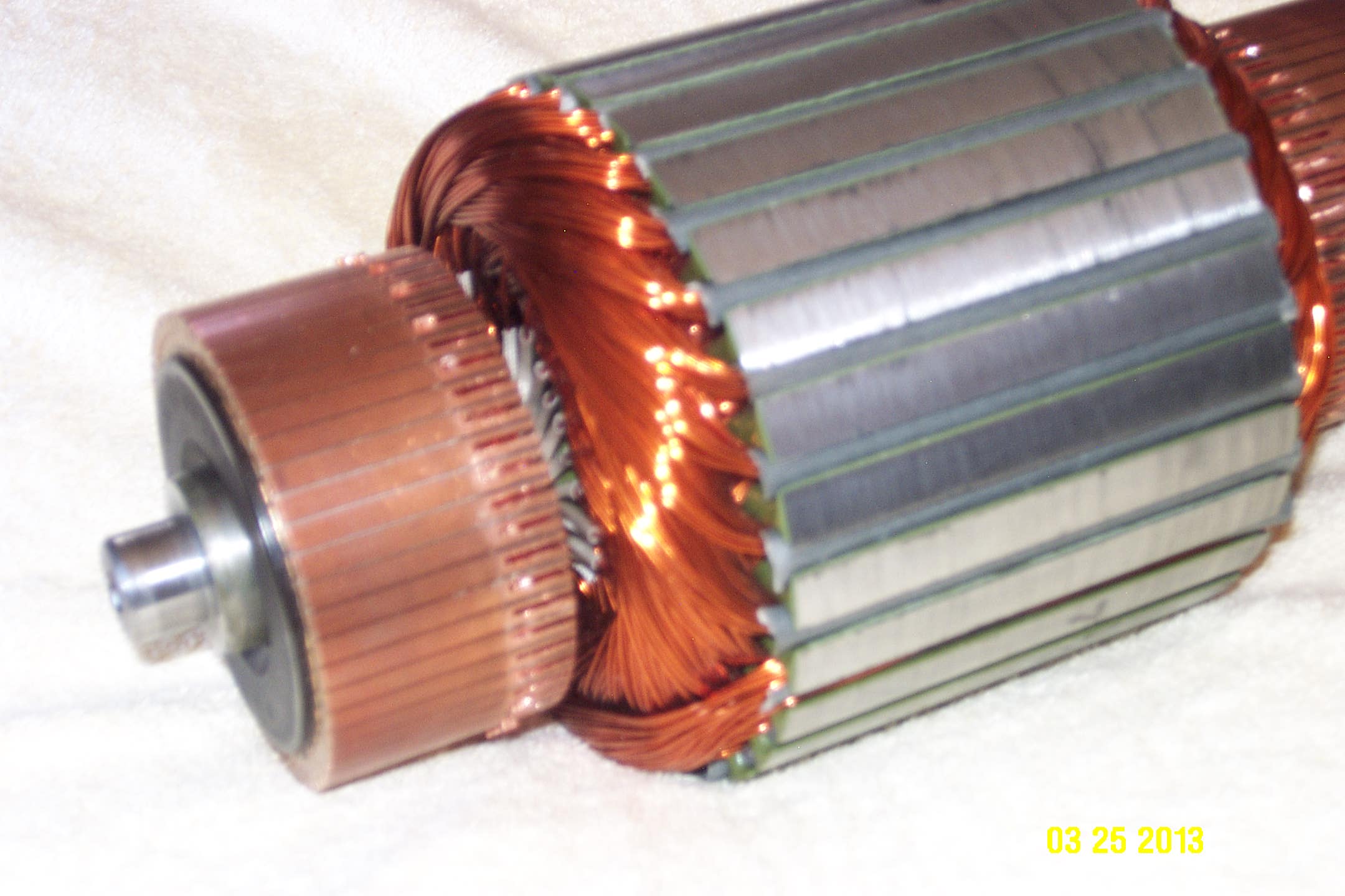

                  • arm. wound
                    Howdy All, Arm. wound, still waiting for my machinist friend.

                      • That Imperial looks grreat!
                        Hello Jeffy,
                        Wow, nice winding my friend! excellent!
                        I expanded the commutator gaps on mine...still have it apart, I cleaned it real good and is ready to be mounted, but was working on another video I want to upload...
                        Ufopolitics
