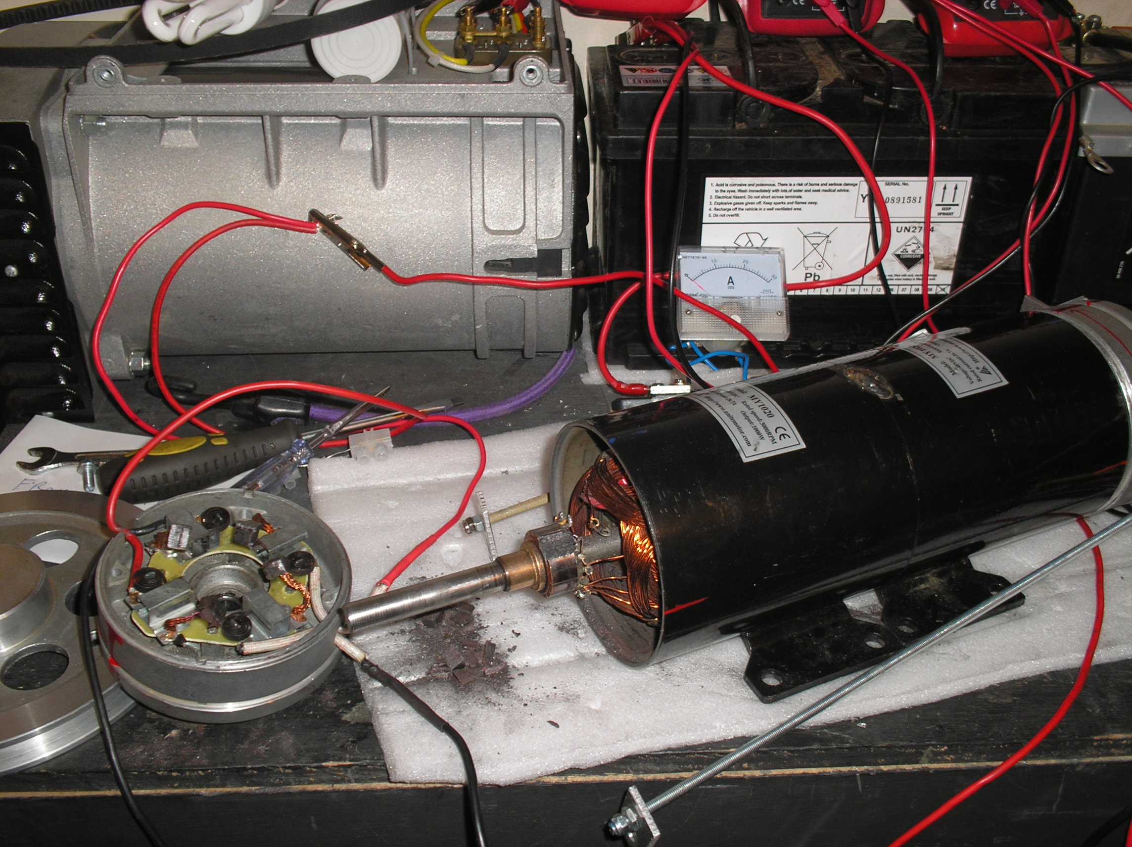

Machine. I actually have an old leather hat and pilot's goggles and was gonna take a picture with it on but that would have taken something that was maybe just a little tongue n cheek to something ridiculous. I know you're kidding and I think the builds are in capable hands. I go back to my little build once in a while and experiment. I found something the other day that looked a little interesting. It looked like with the motor running with the two commutators in series (Half the KV) the current draw was not linear to the voltage increase and RPM or at least maybe not in the same proportion of the original RS motor. This would be a good surprise but it was with no load and I haven't spent enough time to say for sure. I'll let you know if it checks out, or maybe someone else has info on this. Ha, maybe I will get the check book out. I've been reading about 12 21 12 and it seems it's based on the birthday of Christ. Well the problem with that it seems is no one really knows within 7 years what year he was born. Or at least thats what I read. In short the time could have passed or be years away. So don't rush your motors, Take your time and do a good build, you'll probably have some time to enjoy them yet.Originally posted by machinealive View PostHey Dad Hav,
