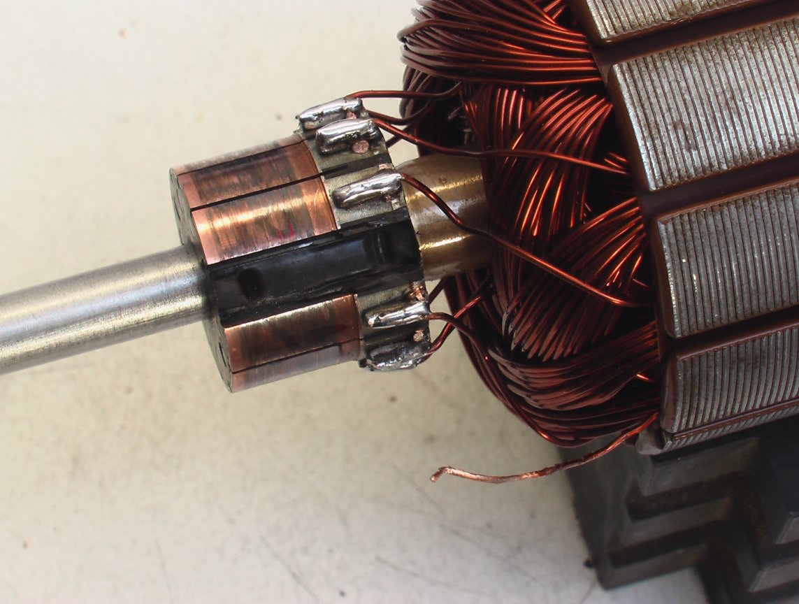

        I am trying to get my generator wound. You said 128 coils, and I understand exactly what you mean, but here is my delima. Say I start with coil number one, and my coils are laid out like so:
        13...14...15...16...1...2...3...4
        On the motor I wound around 1-4 clockwise and then came back and wound around 13-16 counter clockwise. I started between 16 and 1 and ended between 16 and 1.
        Since I am going to wind 1,2,3,4 each coil individually in series and then 13,14,15,16 each coil individually in series, my question is, do I start with coil 1 and work my way out to 4, or with coil 4 and work my way back to 1. Or does it matter? Either way it will be wound clockwise, but I would like to get it right the FIRST time and save some wire, since I wound the motor three times before I got it right.
        You meant Dilemma right?...was searching for "delima"...couldn't find that word meaning...
        First let me ask you...Are the red "things" going to be left there after you are done/finished?...Is that the "Fiber Board" I suggested but in "Fat Red Fashion"?...
        And what are the purpose of those bolts?...I hope you are not "planning" to wind the wire around them?.If that is "Your Plan" is NOT GOOD at ALL...You must wrap all wires around the core itself...or they will fly out (again)...unless You are planning to plastic strap'em...However. I see no point on doing that.
        ..Let me guess...You are going to attach the Pairs or Coils terminals to the bolts? so later on attach the wires to commutators...and take them off?
        Oh, and before you tell me my bolts are too long, I know that. They are only there to wrap wire around as I wind and when I am done will be replaced with short bolts. Wires can then go from these bolts to the commutator.
        Dave
        Dave....Your Bolts are TOO LOOOONG!!....
        You CAN NOT DO THAT!...windings can not go around a threaded bolt...it will strip enamel clear!!...Besides taking bolts off later ...and replace them with shorter bolts will get all that wire loose everywhere!!
        You wind ONCE...as they will stay for good..TIGHT...you may hook terminals anywhere you want, AFTER done winding...but wires MUST be tight around Steel core.
        NOW, Talking about Coils ...PLEASE, USE MY TERMINOLOGY Dave...it confuse ME if You don't do it...I will TALK in MY Vocabulary...
        PAIRS CONTAINS TWO COILS on a Regular Modified Asymmetric Motor...Your Motor HAVE 16 PAIRS/32 COILS...Right so far?
        ON GENERATOR, ALL YOU ARE DOING IS....braking, splitting EACH COIL IN THE PAIR in FOUR SUB-COILS...SAME ORIENTATION, SAME AMOUNT OF POLES PER COIL (FRACTIONATED IN 4 SUB COILS) EVERYTHING...It is just Fragmenting, Splitting each COIL in the PAIR in Four and Four Coils.
        NOW, EACH SUB COIL is IN SERIES (Meaning one after the other...till completing the Four , GOOD, You are done with First COIL in PAIR, that has 4 Sub-Coils...THEN GO TO, the opposite wound COIL and DO THE SAME THING...Four Sub Coils in series, one after the other...till completing the four...and BINGO!!...Done with FIRST PAIR...P-1
        Then start P-2 (PAIR TWO)...and so on and on...
        You Do P-1. P-2, P-3....TO P-16...Just same as you did your motor...So please, forget about the 128 sub coils...it tends to more confusion!...
        So here...For You!
        [IMG][/IMG]
        Let me know if you still have a Delima... sorry a Dilemma ...
        Ufopolitics

          • Originally posted by Turion
            My understanding is that the four north wound sub coils are wound in series and then the same wire continues over to wind the four south sub coils in series. Correct? My question is, WHICH of the four north sub coils gets wound first...number one or number 4?
            EDIT 1:Am sorry did not "Get IT"...
            Ok, still applies same way...
            Position your Armature the same way you did motor...and start Sub Coil 1, AT the same Pole you started to make a Turn...Ok:
            You Finish Sub Coil South 4 THEN YOU GO WITH WIRE TO Sub Coil 1 North, then Sub Coil 2 North, 3,4 THEN YOU GO TO FINAL COMMUTATOR ELEMENT...
            Just as Diagram shows, NOW, YOU MUST KEEP SAME WINDING PATTERN through the WHOLE MACHINE.
            Dave, Follow the same exact pattern you used to wind your motor.
            Start from the same side you did on Motor...and finish the same way you finished on Motor...the same sequence...that is the point...to wind it as your other motor.
            Understand me?
            Ufopolitics
            • Windings
              Torion
              The picture shows 1 to 4 and 1 to 4. By doing it that way you will wind as same pattern but loop each pole untill you get to four. Just link the motor set the same but with a lot more coils stuck in the middle. Actually it does not matter what way you wind them as long as you have four sets of north on one side and four sets of south on the other. What I would like to know, is the commutators set up the same way as motor or two on one end? I guess that does not matter eather. Boy, Torion that thing should sing. I wonder if as in the motor, (more windings = lower RPM and higher torque), (that in your generator, more windings mean less volts and more amps)?
              Dana
              Nikola Tesla
                Correct. However You are "Starting from the bottom Up...working yourself to the Top.."
                Others like to start from the Top and go to the bottom last...
                It is just a matter of "Preferences"...
                Ufopolitics

                      • Hi Ufo,
                        Thanks, very happy you like the build, and thank you for the advise, I have the motor apart at the moment but when I get it back together I will look at it again.
                        One thing I would like to say is that in the video I never allowed it to go to fast, it can go faster, it goes like an incredible speed.
                        A couple of hours after I finished it off and was seeing what it can do, it went so fast that one of the commutator segments flew off, (this was before I made the video. I had since replaced the commutator, see picture below). Now of all the places it could of gone it went straight in my eye.The motor had slowed down by the time it detached because it was held on by the winding, knocked around a bit, then the wire broke near the soldered connection on the segment then off it went. I happened to be in the wrong place at the time, just really unlucky. I went to hospital to get it checked it was quite sore at the time but now its ok and back to normal.
                        I always wear safety glasses when needed but did not think they were needed for this, I didn't expect this to occur, now I wear them when I start this motor up. So just a warning to others to be especially careful.
                        I think also the design of the brushes I am using may have contributed to this by biting into the commutator because at closer inspection I have found that the brushes are angled at the back where the spring is, I'm not sure why they are designed this way. It will cause uneven pressure from the brush on the commutator. I'm going to try filing it back flat but there's not much room. I also put a small chamfer on the commutator segments and the brushes.
                        I can say that when this thing gets revved up it gets scary.

                              Hello Netica!
                              I am really sorry about your Eye Accident!!
                              This Machines output two Parameters (Torque and Speed) in a DIRECTLY PROPORTIONAL Fashion, and ALL your Original Motors from the "Symmetric World" are NOT designed to "HANDLE" those two increases equally now...So please be careful!!
                              I saw the picture, it is incredible how element withdrew so clean out from the mica supposed to "hold" it!!...As there are no signs at all of excessive heat shown on the other elements...you were running "coasting smooth"...not super high like you've said!
                              I will give You a "Present"...so it will NOT happen ever again!!
                              I will show later on, a simple to build "Brush-Bearing" method...a small bearing all steel (no plastic seals) that we will add a pressure copper or carbon fiber outer ring (consumable), with adjustable lever springs...it will "ROLL" smoothly over your commutators...not creating such drag and friction like carbon bars do, since their Vectors of Force are no longer pushing and pressing against commutator bars, as accelerating vectors of force contribute to smooth "rolling coasting"...another one of "My Inventions"...
                              I developed this type of Brush Bearing Tech to be able to "Slide" from different levels of commutation-coils arrangement in the Electromagnetic Transmission for Vehicles...
                              But we could make them here static, replacing the very old method...and then those accident like you had...will be old history...
                              Sorry again about that!
                              Ufopolitics
