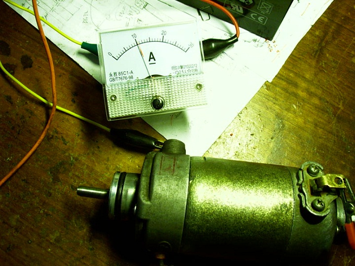

                • Amps Usage ?
                  UFO , Hello
                  I was doing some more goo-fing with the machine/generator and found that when they are running at say three amps on 24 volts, when I put another machine on the generator output, it runs well at 1 amp from the generator even under load. I still think that the amp reading from battery is mixed and not accurate. It seems high and drawing that much current through a one amp analog meter which should blow, it does not. This stuff is getting more interesting all the time and all for the better. I did put a larger motor on the generator output also and the amps are there from the generator for that too... I am not sure how many it will supply but have gotten more out than in, afraid to go for more and melt something. /edit/ Anyway, I now have a complete machine/generator that runs anything up to 54 volts and at least three or more amps. All I have to do now is find a prime mover of correct size and type for the Gen-heads that are waiting. Finding this is proving to be a difficult job. All things in time. /edit/
                  Dana

                  • Hello Nico8k
                    Thank's for your answer nico8k, I will try to look for another motor tomorow.
                    this week end, I am going to buy some electronic parts, take a great breast and go for re-reading the thread.
                    If I understand your motor has 2 points of connection before conversion and 4 points after.
                    I need some wd 40 and I will disasemble the motor this week end, to see inside how it is make.
