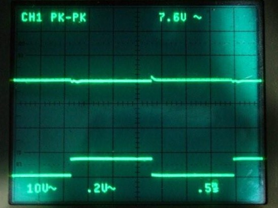

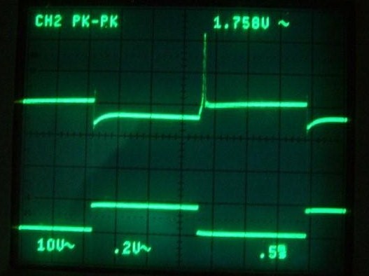

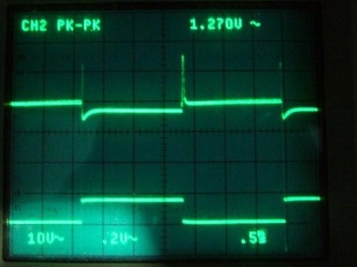

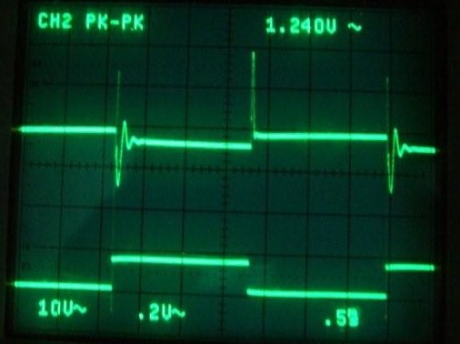

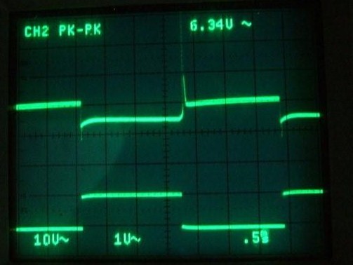

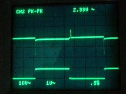

                        It sat until tonight when I placed a 2n6509 SCR in parallel with the middle MJL21194 and hooked up a separate opto for it, so the middle MJL isn't used. A spare home made 4 strand inductor (each strand in series & no clue about the inductance) for my load. Not sure if this is significant, but one of the wires is iron, two ~23ga and one 26ga. A little debugging and I had it running and was seeing nice spikes on the scope. A little more tweaking and voila! The battery started charging!
                        I've attached scope shot across K/A of the SCR. The first (DSCF8601) is charging the best about .01V every couple minutes, then I began increasing the drive voltage (to de-tune it) and show the sequence of shots. Charging gets progressively worse, until the last (DSCF8610) which charges pretty well, but not as good as the first.
                        So here is what stood out for me tonight...
                        Start with a low frequency. 9hz was too low for me to see on the scope, but 50-60 hz worked well.
                        John started with a dead battery. So did I, it's easier to see the voltage rise when you get the circuit tuned.
                        Remember how to tune your SG?
                        Adjust the base current. I did this by adjusting the drive voltage to the optos.
                        Tune to a single pulse. By adjusting the base current on the optos until you get a single spike/pulse.
                        Tuning appears to be independant of the operating frequency.
                        Way past my bedtime tonight. Hopefully I'm onto something and the photos will help someone else!
