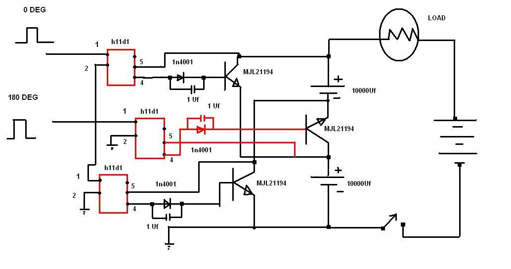

Do you pulse the test switch on Johns diagram by hand or with a oscilator?
nvisser,Originally posted by nvisser View PostJohn K .
No, just leave it on full time - no pulsing. Not sure if this is right or not, but it seems to get results. Longer testing will confirm I suppose.
John K.

I replaced the 2N3055's with matched MJL21194's. The circuit still worked as before. I didn't have any 555's and opto's so just for a test I replaced the test switch with a reed switch that is closed once per revolution by a small bike computer magnet that is attached to my rotored SG. It actually works pretty well all things considered. I get some nice spikes across B3 and it is charging and all the transistors fire at the same time. I guess it works similar to a cap pulser circuit.

nvisser,
The three battery system is just a test to show the switching. So here see if you can get this circuit to work and charge it's own battery. The load must be chosen correctly so the battery is in a state of constant charge. The famous Bill and Ray Scalar charger. Charger is the one I talked about on KABC with Bill Jenkins. Drive it with a flip flop oscillator you can control the speed. Give this a try MR. Jones, I have one of these running at work. If your not careful it will destroy your battery. Also if you take this battery out of the system it will be real hard to charge with a normal charger.
John B

Will it still work if i dont use the MJL21194?
I see it is a update on the scaler battery charger on your old website.THE TESLA SWITCH
I always wanted to build it but the pnp transistors sounded like very small transistors and I thought they will blow immediately. I thougt it was bc108`s, that small tin transistors!! You said on the website that something looked wrong and that you never tried it so I left it
Now this circuit looks worth building. I will start on Monday when I can get my hands on some components
I suppose the toggle frequency should be low to allow the parralel capacitors to charge up properly to 12v before it dicharges in series?
So it looks like the load has to be chosen so that the battery is in constant charge but not overcharging?
I noticed that the opto, transistor setup is the same as on the TS photo you posted with the diode and cap to the baseLast edited by nvisser; 11-21-2009, 06:50 PM.
