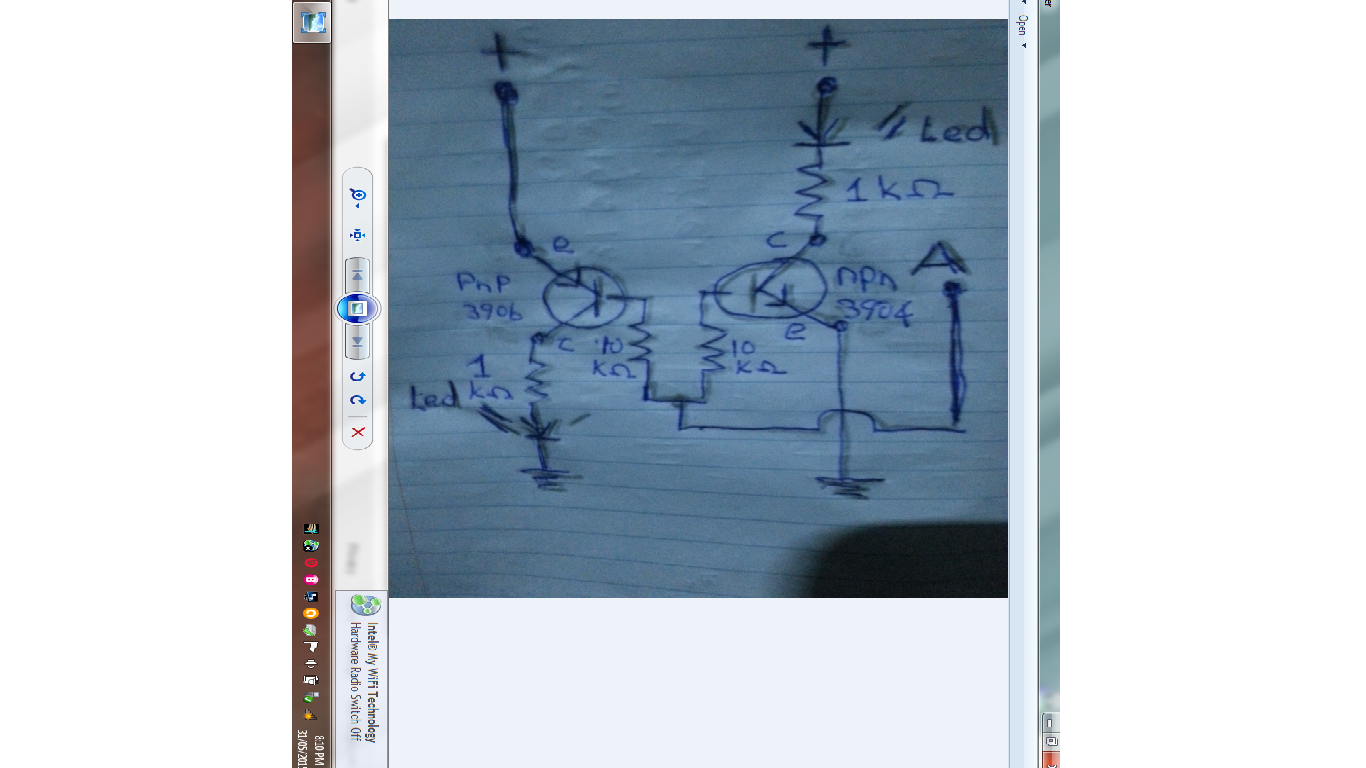

I think that PNP transistor should be connected with collector to the gnd, 1k resistor between base and the 555. In this setup.
