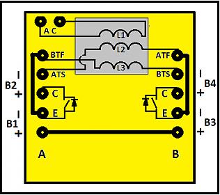

The schematic is this one http://www.matthewcjones.com/power/SimpleSwitch.jpg.
Don't read to much into it its just an outline.
@all
The drawings of the switch's are taking some time so as soon as they are done I will finish up and compile the whole article.
Matt

[ATTACH]8950[/ATTACH]
Matt wrote that there are 2 transformers A & B below?
A- Transformer. 1 -3 KVA or 1000 to 3000 watts. BIGGER IS BETTER.
3000 Watts Step Down Voltage Converter
B- #6 AWG Square magnetic wire at 150 ft, OR #14 awg magnetic wire at 300 ft. Now you can use anything in between the 2 listed wire. But do not go smaller than 14 awg, and DO NOT THINK you can wrap 5 strand of 20 awg together to come up with that size. This a recipe for HEAT and does not work well. You cannot use insulated wire either, this is also a recipe for poor inductance.
Or you can use A or B?
If you need both, what do you wrap the 6 AWG square wire on, iron core or ferrite core? Toroidal core for high frequency? What is the frequency of the operation of switching?
Cheers Mike
I used a 3 KVA 3000 watt transformer with an iron core. Use the 6 AWG square wire on L1 L2 and L3. The transformer is the one that Matt has posted in his listOriginally posted by vrand View PostThank you William for sharing your research and results

This is it 3000 Watts Step Down Voltage Converter Get it disassemble it and rewind it with #6 AWG wire.Originally posted by vrand View PostWhat type of core do you use for L1, L2 & L3?

Hi Matt, the instructions didn't mention stripping out the wiridings on that 3kw transformer and winding the L1 to L3 coils on it with the 6 AWG square wire.Originally posted by Matthew Jones View PostI gave you link to both the transformers I recommend. One is for a large setup one is for a small setup.
Stop drinking so much coffee and slow down when you read the shopping list.
NO FERRITE, NO TOROID.... Just plain old iron plate cores, for starters.
Matt
How many turns/length of feet of wire are for the L1 to L3 coils?

Ya David those will work but you have to get the powerex driver kits for them. And don't fool yourself they'll burn up if you do not set them up right.Originally posted by Turion View PostMatt,
I have been looking for some good switches for this project. What do you think about these
If they are a go, I found them here Powerex Result
David Bowling
I will have literature to cover the wiring with those switch's,in general.
But before you run out and buy those you may want to just get a few small relays 50 amp or something to make sure you can get the thing wired up and running. Those big switch's with the driver are expensive and if you make even little mistake they go. Ask Rosehill
