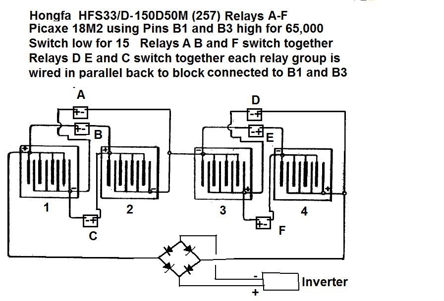

Originally posted by Gills
Do not use a duty cycle at all Turn one side off and turn the other one on immediately. If you use a large capacitor (2-3 farad stereo cap) after your bridge rectifier the inverter will not know you have turned off the power.
Now if you want you can chang your configuration to a transformer setup like my simple switch or just use bridges instead of the transformer.
!!WARNING!! I have not tested this but it should work.
Again use as little duty cycle as possible. Depending on the hong fa switch you are running and the capacitors that are in the Inverter you should probably tune well around 40 to 60 hz (HZ being 1 complete cycle), But you could go lower if needed. If you are using Mechanical relays don't switch any faster than about every 10 seconds.
Hope that helps
Matt
