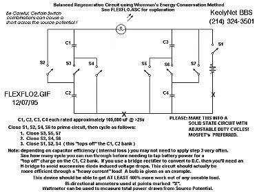

    There's an interesting article about the Tesla switch at keelynet:
    The Wiseman Theory of Energy Conservation
      http://www.textfiles.com/bbs/KEELYNE...GY/flexflo.asc
      Greetings! Thank you kindly for the link. In all my travels I've never come across that document before. Thanks sincerely.
      The experiments mentioned therein are exactly the kinds of things I have been doing on my workbench. If only I could work as fast as my imagination does...
        Hi have you got a link to the diagrams, as the attathments are not very good quality and are unreadible when printed out
        • I used the schematic provided in the mueller report to arrange my transistors. i am using a bipolar motor with 6 independant triggers to run the switching system. As soon as i turn it on the transistors started to heat up which the current that was going to my motor power coil, the transistors never heated up before. I traced back through the schematic and found out why they did that. The two transistors that are closest to the bridge create a hot short when they turn on. I disconnected these two and left the 4 that create the alternating current going to the bridge and it functions fine now. Still have to load test it though.
