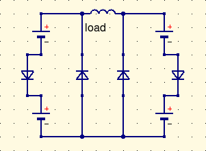

                        • I'll try to explain my circuit.
                          Look at it having 4 stages; plus-zero-minus-zero.
                          You can delete the diodes at stages plus and minus where minus is just like plus in a mirror, right? Nothing new here.
                          In stage zero You can delete all switches as they, in theory, are all off.
                          Then You can redraw stage zero as the coil connected to a rectifier-bridge with the batteries inside the bridge and the output of the bridge short-circuited.
                          I would like to minimize the time it spends at the plus- and minus-stages and maximize the two zero-stages.
                          I'm not sure if this is the theory, but it is my intended theory
                          I hope this explains what I'm trying to do.
                          Hob Nilre
                          http://www.youtube.com/nilrehob
