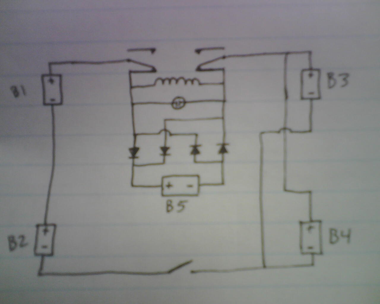

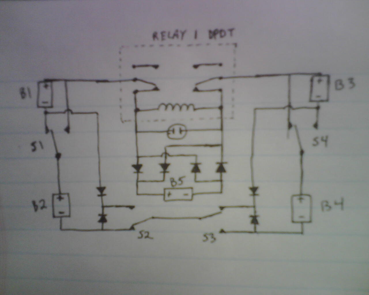

    Here are the schematics. Also, I just watched nilrehob's video. With my schematic, I have only 4 switches planned for the battery swap. It may be an idea that could help you?
    Again, the first diagram is just of what is in my video. Not all the switches are completed yet. The second is what I'm working on.

        I have been looking at your second circuit, and it seems to be variant of the Tesla-switch, but without rapid switching on S1 to S4, which I believe the TS have?

          • Switching in the schematic
            Yeah, I finally got a chance to read through all the posts in this thread, and most of the documents that were linked to. Great info, most of which I had not seen yet.
            About the switching in my schematic, actually those would be mechanical switches is the plan anyway. I plan on making a newman to do the switching for me. Kind of a 2 for 1 deal. Getting good work out of it, and rapid switching. I also was thinking making my own relay using permanent magnets with the switching. This way depending on the polarity of the current in the coil, the switch will either push away, or attract towards.
            Thats where I'm at so far. After reading the whole thread now, it seems most are already farther than I am, but I will try and do my work slightly different than all the rest so maybe my work will help everyone too in some way! Thanks for your comments.

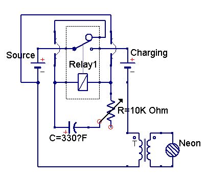

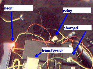

                  • Hello all,
                    Interesting thread here. I don't have the resource to replicate it but I will keep reading this thread. Cold resistor in the document really interest me so I make a replication of T2 diagram with relay. It make a really good charger.
                    A couple of difference from Imhotep Radiant Oscillator:
                    - need two battery
                    - No spark at the relay !
                    - No heat at the relay !
                    - directional. Neon glow both electrode at IRO, only one at this replication.
                    I still don't test wether the battery has been surface charged or not. 6.6 to 10.2 in two hours for broken 12V 7Ah Gel battery.
                    I use 12V computer power supply as source. I guess this charger will stop charging when the battery reach the same voltage as source. Is it?

                        • @ sucahyo
                          Second picture, it looks like You're short-circuiting the source-battery when the relay is at rest?
