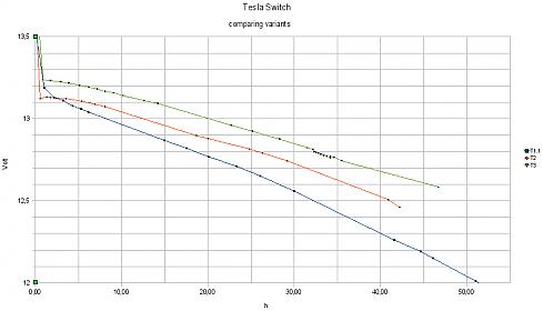

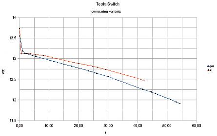

                The only thing I've seen as a common ingredient in most setups (be it a Bedini motor, Newman motor or what have You) is the coil and the spikes. I've finally taken the time to read through the lab-part of the Mike Mueller report. It clearly has a coil (a 110/12 transformer, mentioned at page 9) and they switch at 400Hz (figure T-2, page 8).
                I have finally got me a new relay (I fried the old one as one of the batteries has swapped its + and -, tricky to remember when You are tired and/or hungry) so I could continue my tests and compare different setups (but using the same batteries and the same lamp as a load).
                Both tests lasted for >40h, the batteries are sealed led-acid 12V 1.3 Ah, lamp is 12V (unknown Watt, haven't tested it (broken amp-meter), as I'm comparing different setups i figure its irrelevant (but ohm-meter says 14 Ohm))
                Test 1: the batteries in parallel. The average voltage dropping rate over the batteries was 0.023 V/h
                Test 2: TS at 24Hz (+/-1Hz) using the relay. Waveform over lamp was about 75% on (+12V or -12V) and 25% off (0V) (+/- ~5%). No coil, diodes, capacitors or anything but the batteries, the relay and the lamp. The average voltage drop over the batteries (average voltage) was 0.0158 V/h. I could detect very small spikes, a few volts only, I guess they where from the inductance in the wires, just a guess though.
                I'm charging the batteries for my 3rd test now which will include a coil of some sort.

                          • I have just finished test 3 which was just like test 2 but I added the coil (but no diodes whatsoever). The coil is 24.3 Ohm and (I think) 166 mH (but I may be wrong). The lamp is just about 1 W (81.2 mA at 11.93 V).
                            So:
                            T1 blue; all 4 batteries in parallel and the lamp
                            T2 red; switching at 24Hz (~75% on) and the lamp but no coil or anything
                            T3 green; as T2 but with coil
                            I don't know why T3 is so much above the other two right from the start so I'll do T1 once again as soon as the batteries is up again.
                            T4 will be like T3 but with diodes.
