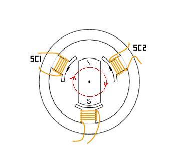

                          • hi all. just curious to see if my interpretation of lenz law is in line with the general concensus out there.here's a pic of a generator. the way i understand it, with the rotor turning clockwise, if generated current is flowing in stator coil 1, at this point of rotation, then it's core will develop a south pole, facing the departing rotor pole north. at the same time, if generated current is flowing in stator coil 2, at this point of rotation, then it's core will develop a north pole facing the approaching rotor pole north. this is why it takes a lot of work to generate a lot of power.
                            when you run a motor with no load, the rpm it runs at is the point where the simultaneously generated voltage,which is back emf, reduces current to where the motor can't spin faster, for a given input voltage. if you then mechanically drive that motor faster it reverses the current flow, and the motor is now generating.
                            it's interesting to contemplate what would happen when 2 motors are coupled with a ratio like 2:1, and tried with different placements in 3/4 bgs setups, or other types of circuits.
                            cheers.
