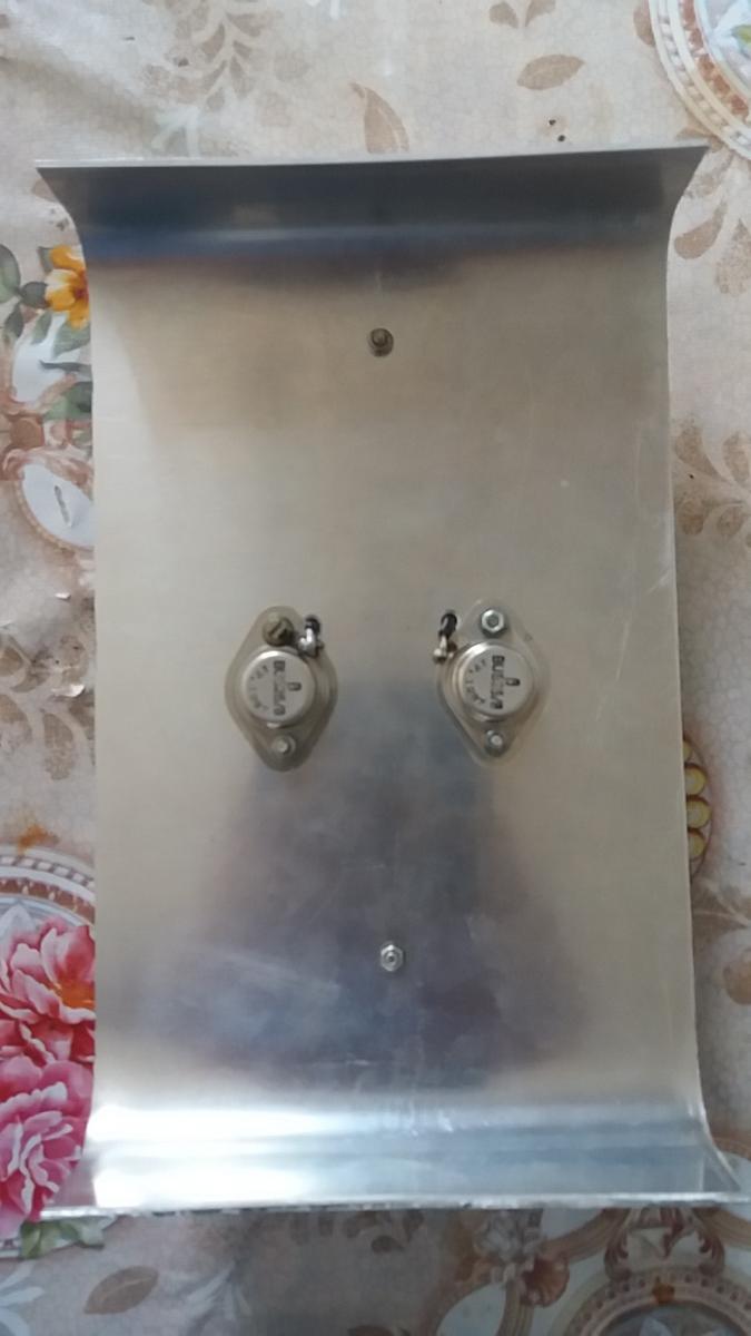

          I have been working at a few high frequency power amplifiers with bipolar transistors, BJT's. Tonight i have finished one of them, the second one, and i have also improved the one with 2SC3264. Tomorrow i will post pictures of them and the schematic diagram i used.

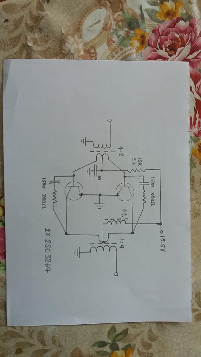

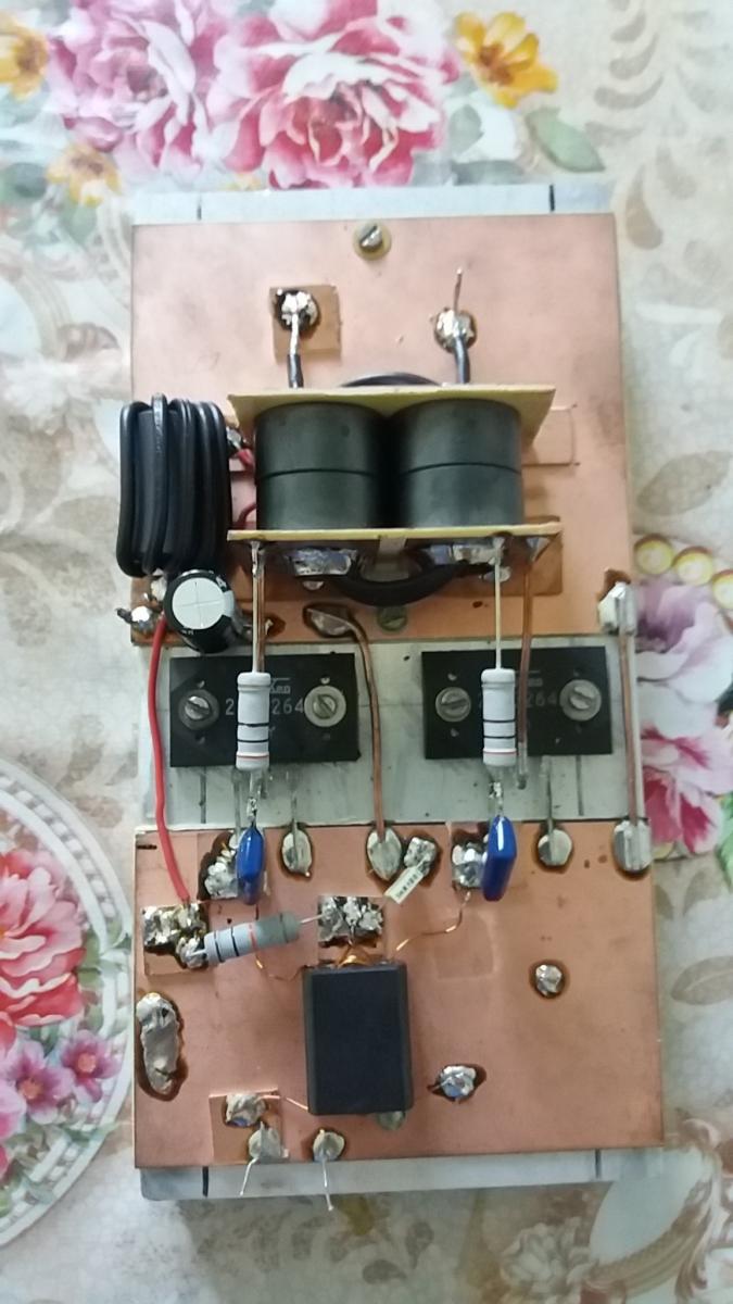

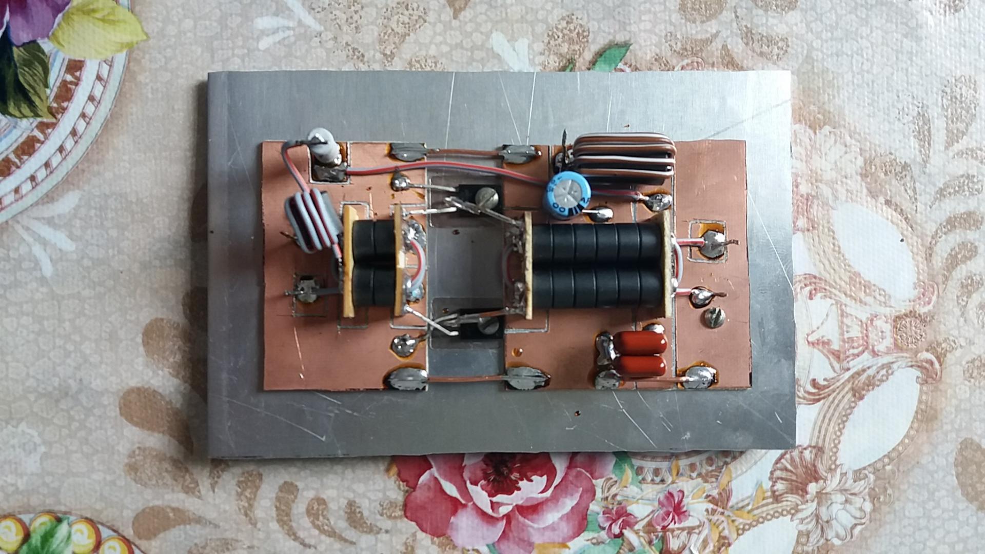

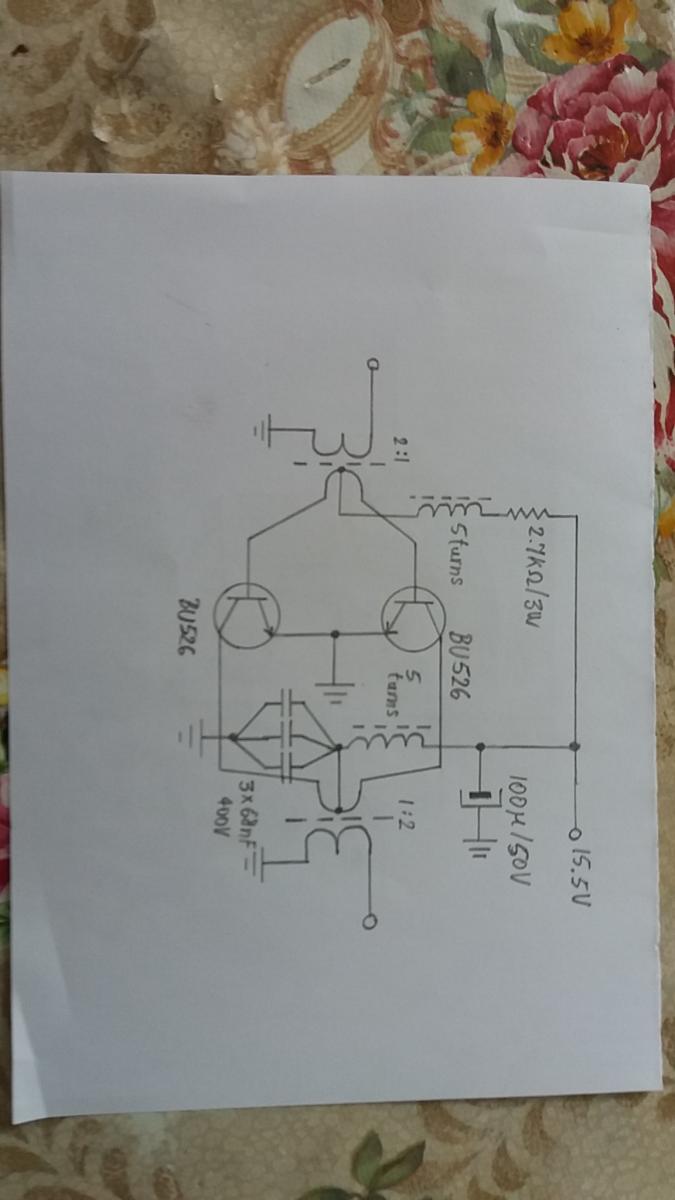

              These are the two amplifiers i have been working on lately. The one with 2SC3264 you already know of but i have it's schematic diagram here and you can see it has been improved.
              The second one is a very special one for me. It works very well up to 9MHz which is more than enough for me. The ''experts'' in my country were always unable to provide such schematics so i could build the amplifiers. I had to come up with designs in order to have my desire fulfilled.
              I swear my people are w huge waste of my time....
              BU526A8 is an RF transistor which has a transition frequency of 10MHz. So this amplifier is very good up to 9MHz. It has a beautiful sine wave but you have to follow the design well.

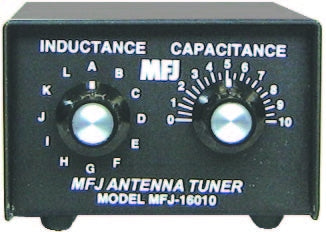

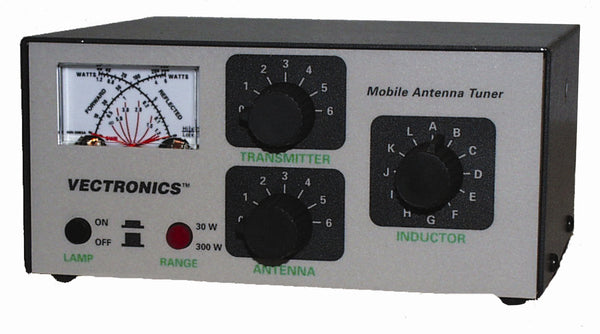

                        here are a few to look at, not that you are going to buy either, because they only go down to 1.8MHZ, so not sure they would work for you anyway,
                        but the downloadable instructions also have full schematics (or they did last time I checked)
                        The VC-300M Mobile Antenna Tuner is compact, lightweight, easy-to-operate and is out most economical tuner. Its compatible with any mobile antenna and any mobile HF transceiver and is compact enough to fit the most compact car. It can also be used at home with dipoles vees, verticals, beams or quads fed by coax. Backli
                        Variable L-Network Random Wire Antenna Tuner The MFJ-16010 is a variable L-network random wire antenna tuner designed to match the low output impedance of your transmitter to the high impedance of a random wire (or vice versa). It will match almost any random length of wire to any transmitter from 160 thru 10 meters. T
                        hint, if you put the capacitor in series with the coil it will be easier to tune on the transmit side, but you will get more interference on the receive side, so use a parallel capasitor on receive and transmit or just only on the receive. (I have no idea if you are wanting 2 way communication or just one direction)

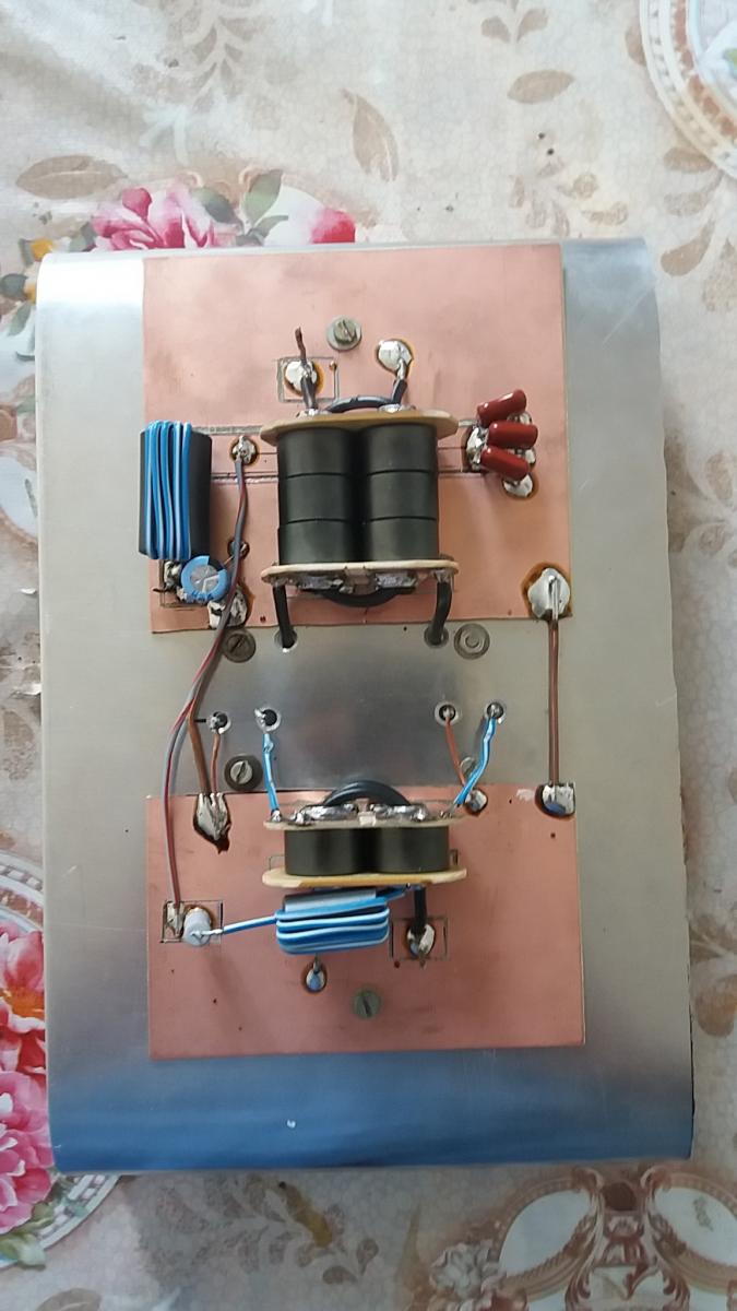

                        • Here is another amplifier built by me yesterday. It's sine wave is very beautiful but because i didn't have material 43 i had to use something else from Kemet. It is a high frequency core and it answers to frequencies from about 5MHz up to 300MHz. So this amplifier, though it is very small, only 12.5W, would have been very good to act as a driver for bigger ones, can't be used from 1MHz up to 5 because of the transformers. I have to get a bank account and a debit card and buy material 43 from Mouser. As i said it's sine wave is beautiful but from 5MHz up. It's schematic diagram is the same as for the one that uses BU526 but in this case the transistor is BD139 and the biasing resistor has the value of 47kOhm and an idle current of 40mA. The supply voltage is 15.5Vdc. I placed a 3W biasing resistor to last a lifetime
                          • looks like you are getting things working, good to see
