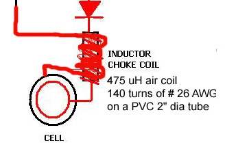

                            choke modification
                            check out attachment.
                            this is what Meyer's is doing with the choke. His schematics he shows one at + and one at - tube
                            they are bifilar wound on same core of same turns. check out tech brief for details.
                            if there are 140 turns 26awg, wrap another 140 turns on top of that in exact same direction. the end that is connected to inside tube, connect outside tube to the new wire on that same end. the other end of new wire, connect to the negative source.
                            in this configuation the magnetic fields in the bifilar choke will oppose each other. this is exactly what Meyer's is showing. I will start a new thread just on the bifilar choke so we can put it all on the table.
                            also, I am leaning to totally using outside tube as positive and inside as negative.

                              • #90
                                Thanks Aaron
                                I will get to work on this and let you know how its works out, I am glad U pointed this out, as i do recall from the tech brief the bifilar choke.
