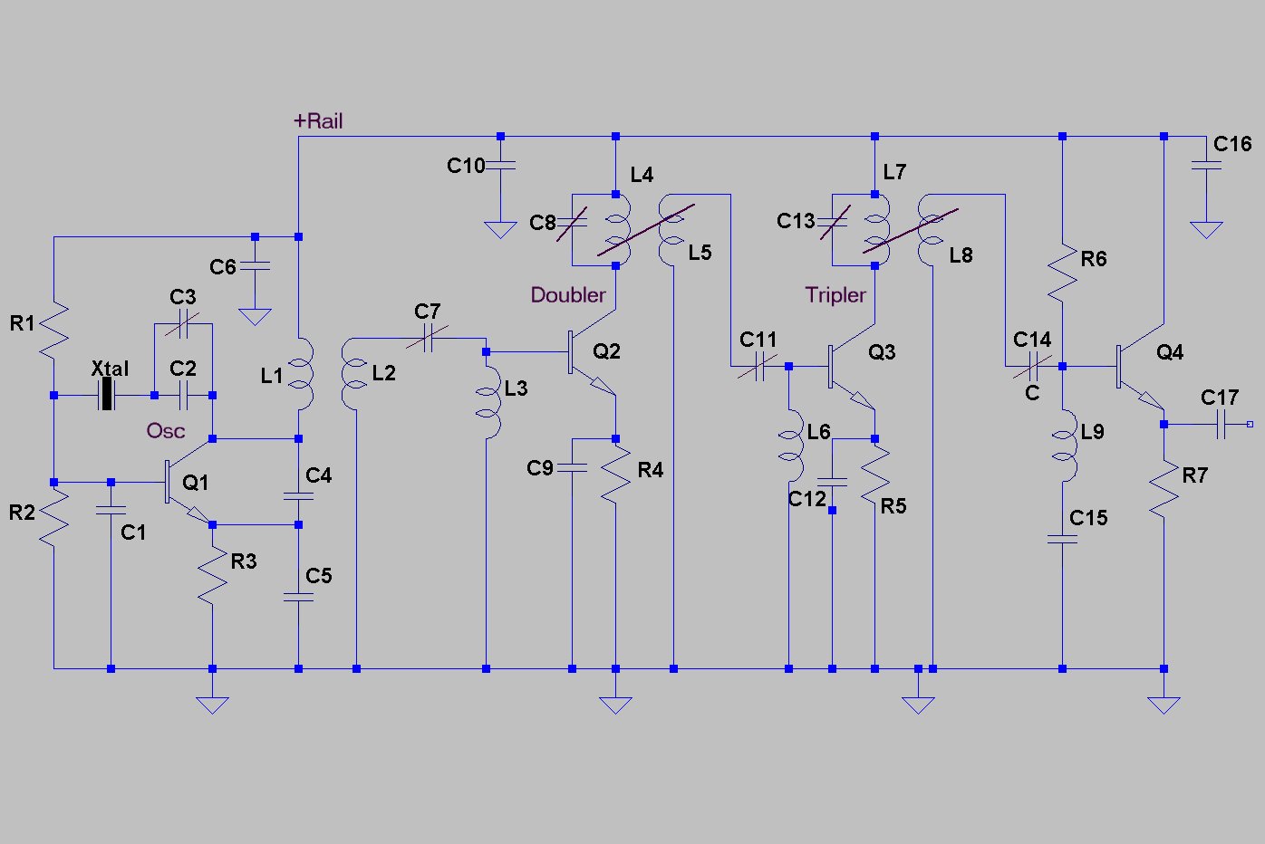

      This is the circuit I'm going to build, simplest I can come up with
      so far:
      Is there any concern about needing it to be square wave or sin wave
      or can this signal from this oscillator simply be plugged into the doubler?
        so far:

                    • Thumb Rule Diagram
                      @All
                      Okay here is a circuit that would work, but one needs to give it values and that depends on the xtal, the transistors, etc.
                      I will wave my normal design fee here.....

                      I just ran a simulation and R7 for the power we want will be an inductor and not a resistor, so keep this in mind when doing the follower.

                        • thanks Dr. Stiffler!
                          Originally posted by DrStiffler View Post
                          @All
                          Thank you - Amazingly fast!
                          I'll have to redownload the free version of spice and see if I can
                          experiment with the values. Too many things to learn and not enough time.
                            @Aaron & All
                            Acouple of points on the circuit. The osc is a crystal stabilized, Colpitts in design. One might find one very similar in a ham manual for 2-meters. The coupling caps are variable and the tank coils should be selected to be resonant at the desired double and triple frequencies. Standard formula works here, want a high Q so wire if built should be like #24. The whole circuit should generate at least 2W at the emitter follower for a short end drive to a low power linear.
                            Bypass, bypass and bypass again to a good ground plain (metal) no wire to wire here or wire wrap. Coils should be positions so that they can have a metal shield between to stop feedback. Look at a few ham manuals or a radio engineers handbook to see some good layout methods.
                            Good luck and if its still going (the thread) after my load decreases I might build one up just for the heck of it.
