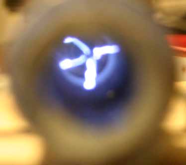

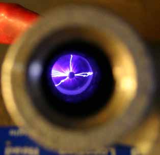

        • Originally posted by dave_cahoon View Post
          My Plasmatron:
          Time to test it.
          Mybe connect it between the PCV Valve and Intake Manifold..
          Dave
          You don't intend to suppress the sparking ?
          • Originally posted by sucahyo View Post
            Yes it will aid the corona, If I tweak the center electrode back a bit more.
            It is only arcing over once every few seconds. (exposure time 6 seconds)
            Dave

                                I filled the reactor with propane. Closed it. Run the HVDC.
                                And the sparks are defiantly a different color, more greenish white.
                                I'm still here..
                                Will haul it outside and try flowing the propane through it to a burner.
                                Dave
