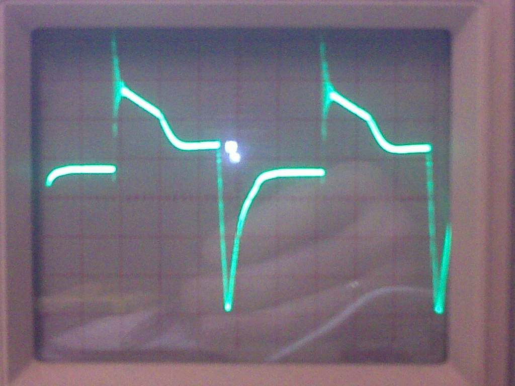

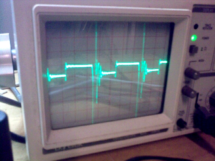

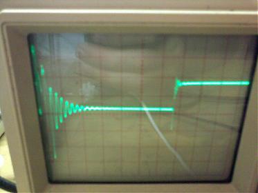

        Picture resonance1 and res2 are taken on my wfc. The setup is just a wfc hooked up to a 50% squarewave oscillator with a FET as switch. The odd thing i saw was that crazy resonance ring when the puls was zero.......
        The 2n3055 pic is indead the 50% squarewave oscillator with a 2n3055 as switch. The reason i tried that was the fact that the FET is having a build in diode that might have trickerd the resonance.
        I was right. Without that diode, you see a big negative dip on the scope.
        (I know, the positive squarewave is not looking very nice, but you have to look at the dip )
        Next step is to hook up a diode that works as a crowbar.

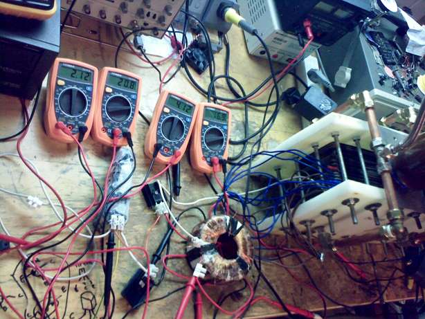

            Conclusions:
            Output FET: 43.8Vrms by 4.22A = 184W
            Input WFC: 36,5V by 8.08A = 294W
            Output AC Variac: 79Vac by 4.9A = 387W (different set of meters as the other 2 measurements points.)
            Gasoutput: ca. 2 minutes for 0.5 ltr
            Strait DC into wfc: 37.4V by 7.62A = 285W
            Output AC Variac: 41V by 9A = 371W
            Gasoutput: ca 2 minutes for 0.5 ltr
            Conclusions:
            1. My meters on the AC side where not identical as the other 4 meters, so a
            mismatch is very possible between AC power and DC power.
            2. My circuit is a perfect converter for squarewave to strait DC.
            3. No OU or any gains what so ever compared to totall input vs output. (from trafo till
            wfc)
            4. Strait DC still wins against any kind of pulsing circuits.
            As you can see, lots of time is again consumed with no results, except the gain of knowledge......
            bammer.......
            Steve

                  I am still puzzled with the negative dip i seen on my scope....Not sure what that is, or how to handle it. I thought i knew......
