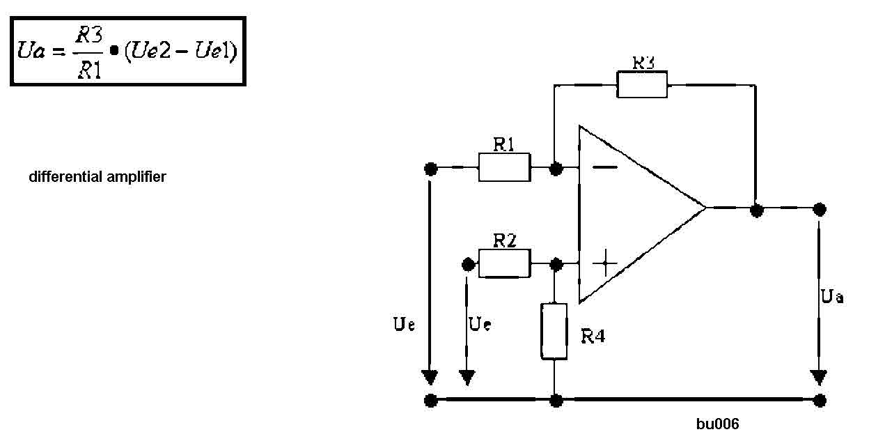

Looking at OPAMP A24 at Figure 4 it seems to be a differential amplifier: Operational amplifier - Wikipedia, the free encyclopedia
At the non-inverting input (+) there is a constant (adjustable) positive voltage.

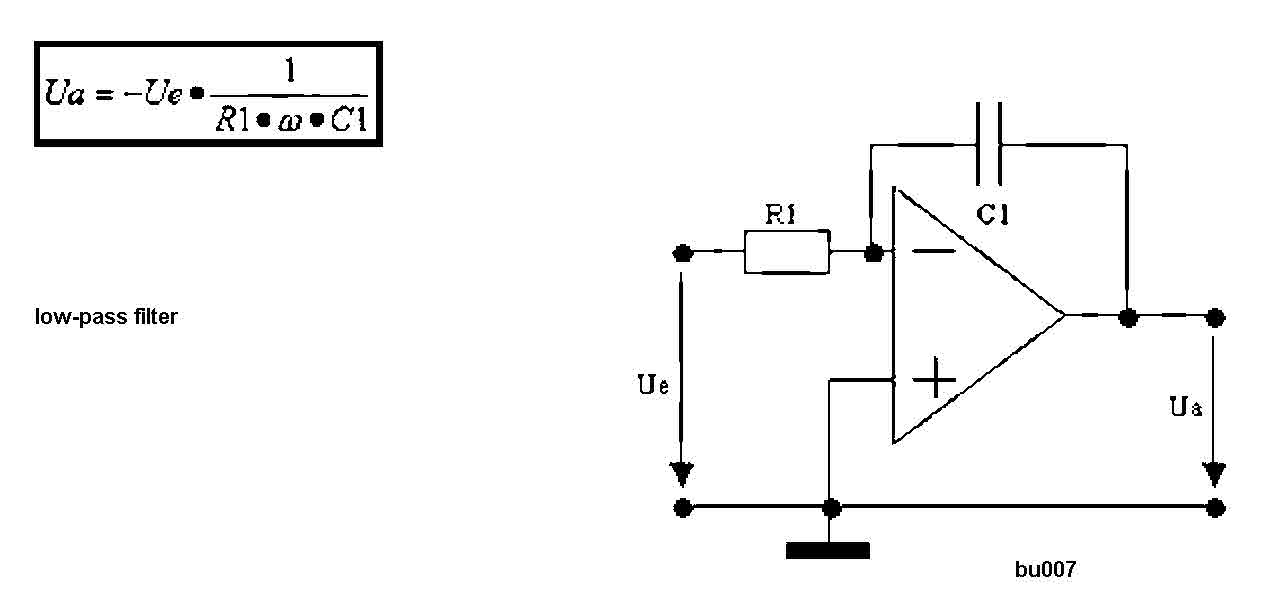

At the inverting input (-) there is the (slowly) variable positive voltage from the voltage follower A25 from system control J. C4 seems to be a low-pass filter element (bu007) added to the differential amplifier (Introduction to FiltersLast edited by bussi04; 09-09-2009, 10:23 PM. Reason: added information P3 P4, error correction R1=R2 R3=R4
