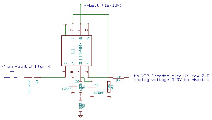

there is an outstanding task for integration of frequency to voltage conversion as substitute for SM fig. 4. Point "J" seems to be a variable frequency source that has to be changed to linear voltage between 0V and Vbatt.
I have found LM 2907 http://www.national.com/ds/LM/LM2907.pdf
