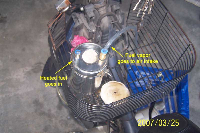

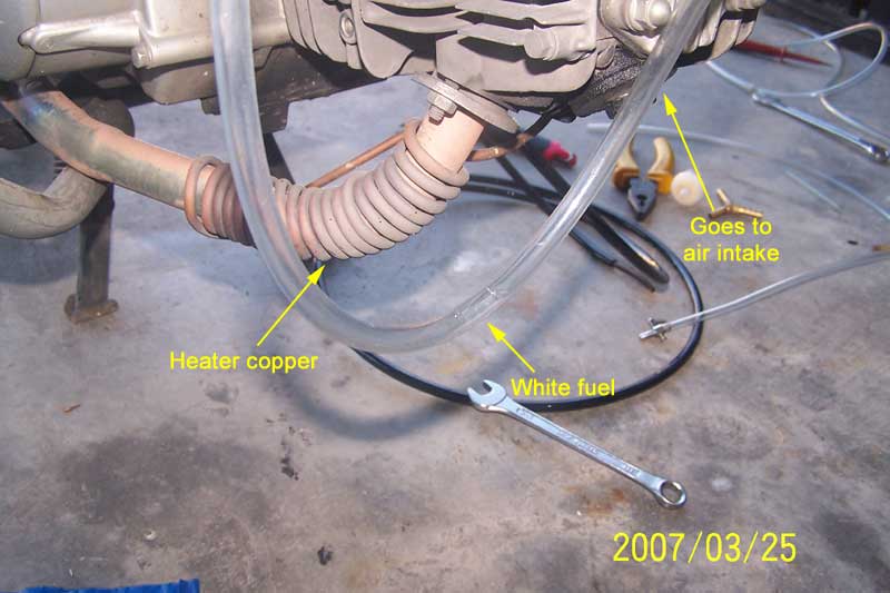

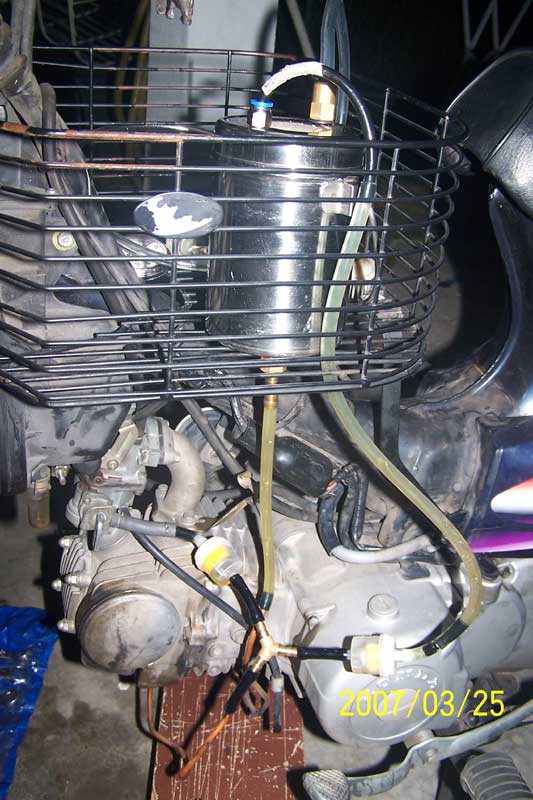

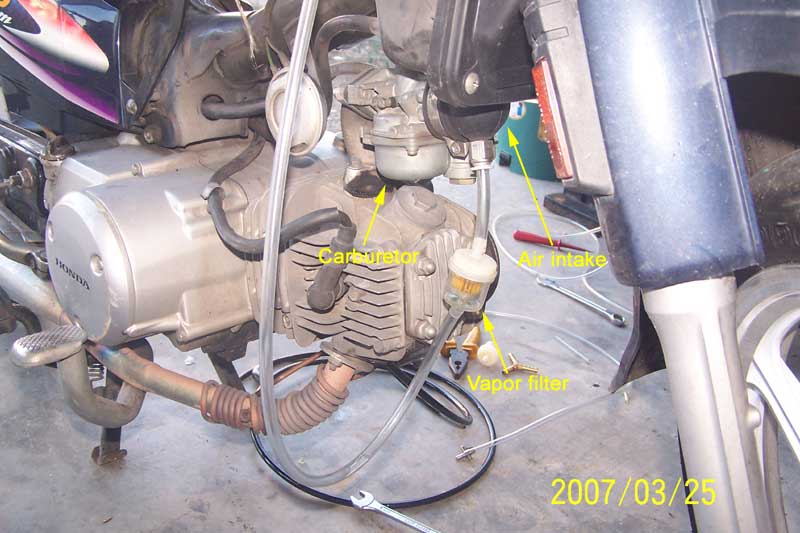

Hi! Kumaran;
Good pics. of the system on your motorbike! I think another part of your problem is you are getting the fuel too hot(I assume you are using gasoline for fuel) and causing a problem we can have here in hot weather called "vapor lock" or something like it. Try using only 2-4 turns of copper tubing around the exhaust. It will decrease the pressure & be a lot safer & you won't need the S.S. container or moisture filter. If you want to try it in the car wrapping tubing around the radiator hose or water heater heater hose should supply all the heat you need, but you really shouldn't need it as has already been said (by RedMeanie, I think) as the HHO system should work fine on it's own.Antiquer

Hi ANTIQUER,
Yes, I realise of hot fuel after first test using 20 turns of copper tubing. I'm a bit lazy to undo the things assembled so I try different ways to make usable. Still the setup can be used for steam injector into air intake. Instead of gasoline, use water to boil and the steam goes into air intake.Originally posted by ANTIQUER View PostHi! Kumaran;
Thank you for reminding me on using hot fuel for car. I still have some extra copper tubing. I may wrap 4 turns of copper tubing onto radiator hose to heat the fuel before enters carburetor. Just wanna see the difference in fuel consumptions. I hope this weekend test give better results by using all kind of alternative method.
