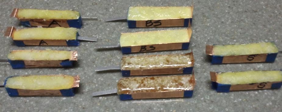

                              • New Glue Cells
                                @IB and ALL:
                                The 2 cells on the left bottom are the control cells. 1.34 Volts and 13ma after 6 hours. The 2 cells on the left top had alum added and they are 1.38 Volts and 18ma after 6 hours. The 2 cell center bottom used Gorilla Glue and they put out 0.0 V and 0.0 current. The 2 cells center top had bath salts added and they are at 1.38 Volts and 18ma after 6 hours. The 2 cells on the right were prepared by painting wire glue on the copper and applying silver leaf to the copper. They are reading 0.84 Volts and 8ma after 6 hours. With the exception of the gorilla glue cells, I used wood glue in all the other cells.
                                @JB
                                Looking forward to progress reports on your new star cell. Sure does look like a winner.
                                I agree that it would be nice to identify other materials with the same affect, especially something more readily available.
                                Brad S
