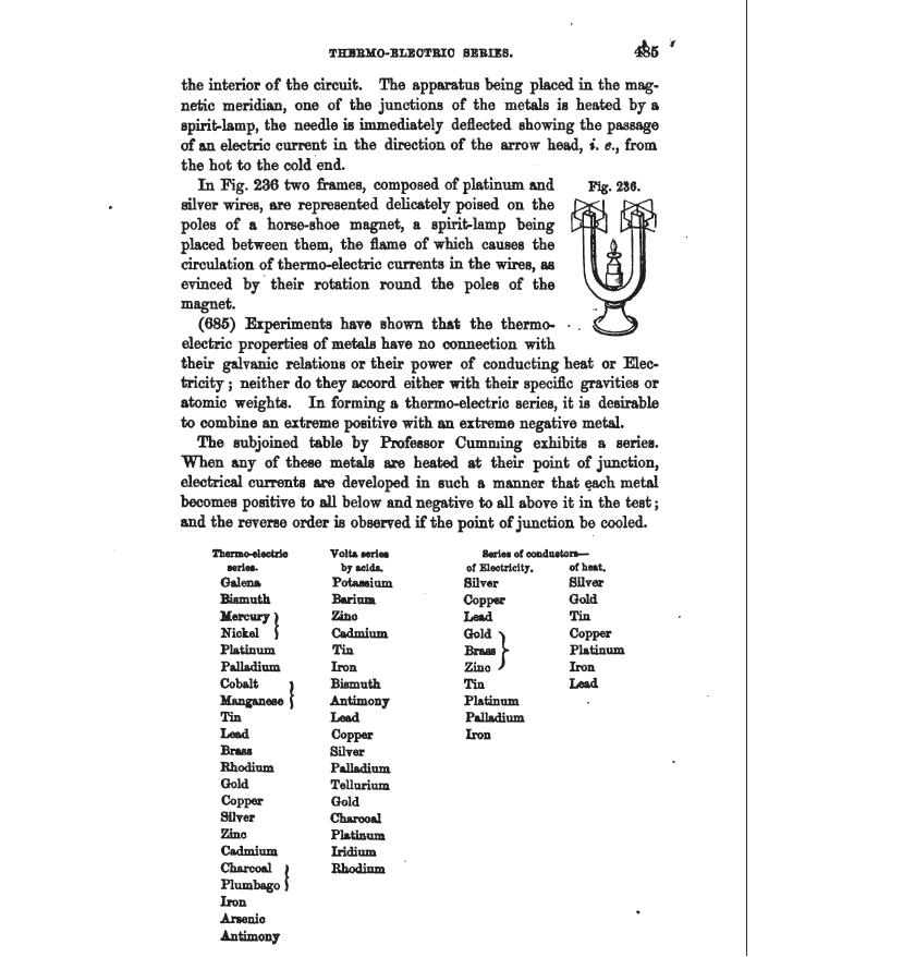

      • Hi every one i am back on line after a year off , i have been wanting to post this for months ...
        • Originally posted by mk1 View Post
          hi mk1, this looks very interesting, do you have more from this book? or the name of the book? cheers
          carlos
