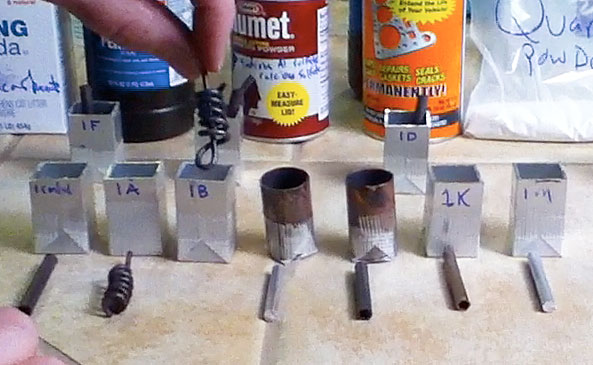

Plates are on my todo list as soon as I fine tune the household mix. But, looking at this picture, there isn't a ton more surface area for 1B coil than there is for coil for 1A. I'm holding 1B coil with the end of the coil looping into the center of the coil and out. As you can see there's maybe an extra 15-20% more copper than a regular coil but we're getting twice the amps. Induction maybe?

Thank you. How about relative distance, is it the same? Maybe the rule is same as electrolysis, more surface, closer distance, better electrolyte increase amp.Originally posted by everyidea View Post@sucahyo
If it is special shape that make the difference, maybe CW and CCW make a difference.
@sucahyo
Not sure what you mean by relative distance, but coil 1A is actually one loop longer than coil 1B, due to the need for the loop on the end of coil 1B. They where wrapped around the same pen and spaced identically between the windings. The only difference was that 1B looped up and straight through the coil. I'd like to make a larger cell that has multiple coils inside themselves and also test winding directions...

Thanks for the explanationOriginally posted by everyidea View Post@sucahyo
Thanks,
rw
. I meant distance between copper and alumunium.
Yep, same distance. They where rapped around the same pen so they had the same diameter and both where placed in the dead center of the cell.Originally posted by sucahyo View PostThanks for the explanation
