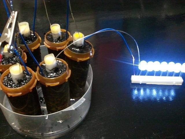

Just a quick update with the standard aluminium. I built a burnt copper version and saw the same voltage but a tiny increase in amperage, 30uA, to 160uA, 0.568V.
It's now on test with the other one and i'll try leaded solder too.
Here's that cell and, btw, i've started using a different coil type for 'Penny' type oscillators. Ya know those small silver pots on old radios ? well it's the ferrite inside that can be turned with a small flatblade screwdriver. 150 winds of 40 gauge from a relay, then a twist to form the center tap and then carry on with another 150 winds. Just another type of coil.
