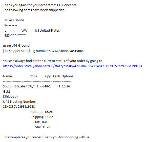

                        Herbie, that takes way too long in my world, especially if you don't have all the other chemicals to make it.
                        The cheapest source for small quantities I ordered from was CQ Concepts Sodium Silicate - CQ Concepts check it out.
                        Attached is a copy of my invoice .
                        Mike
