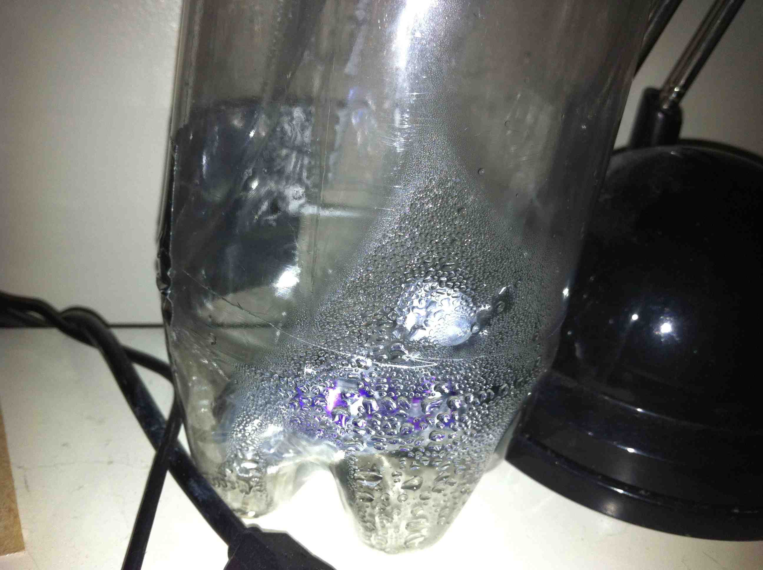

if you put that cell inside a bottle (like I did on my videos) you will see the water condensation on the walls of the bottle which means that indeed you have absorption of water by the cell and evaporation all at the same time.Originally posted by ibpointless2 View Postyeah i was think the same thing about the Epsom salt will absorb water from the air but something else is happening. The cell keeps loosing power. If the cell was using water as the median than the amps would stay the same or go up. So if the Epsom salt was absorbing water from the air than the cell would still be holding its amps or going up in amps but its not. Since the cell is going down in power then I would assume its loosing its water content. The cell is still above 1.5 volts @ ~3mA.
You also must keep in mind that when I combine the Epsom salt with the sodium silicate it became some very different now. Its a magnesium-silicate-sulfate compound now.
You will also notice something very strange if you use a LED. The water will condensate AROUND the area where the LED is shinning. Very strange!!!
THat's why I am testing cells inside the plastic bottle. They all stand much longer in time running. That does not mean the Mg is not consume though.

Originally posted by plengo View Postif you put that cell inside a bottle (like I did on my videos) you will see the water condensation on the walls of the bottle which means that indeed you have absorption of water by the cell and evaporation all at the same time.
Fausto.
