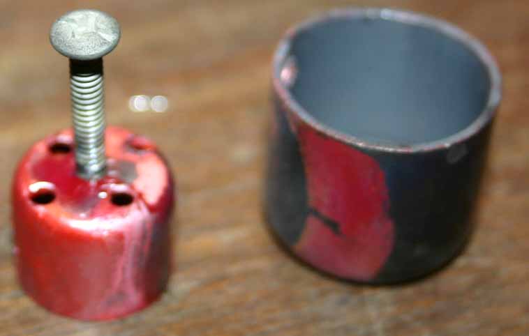

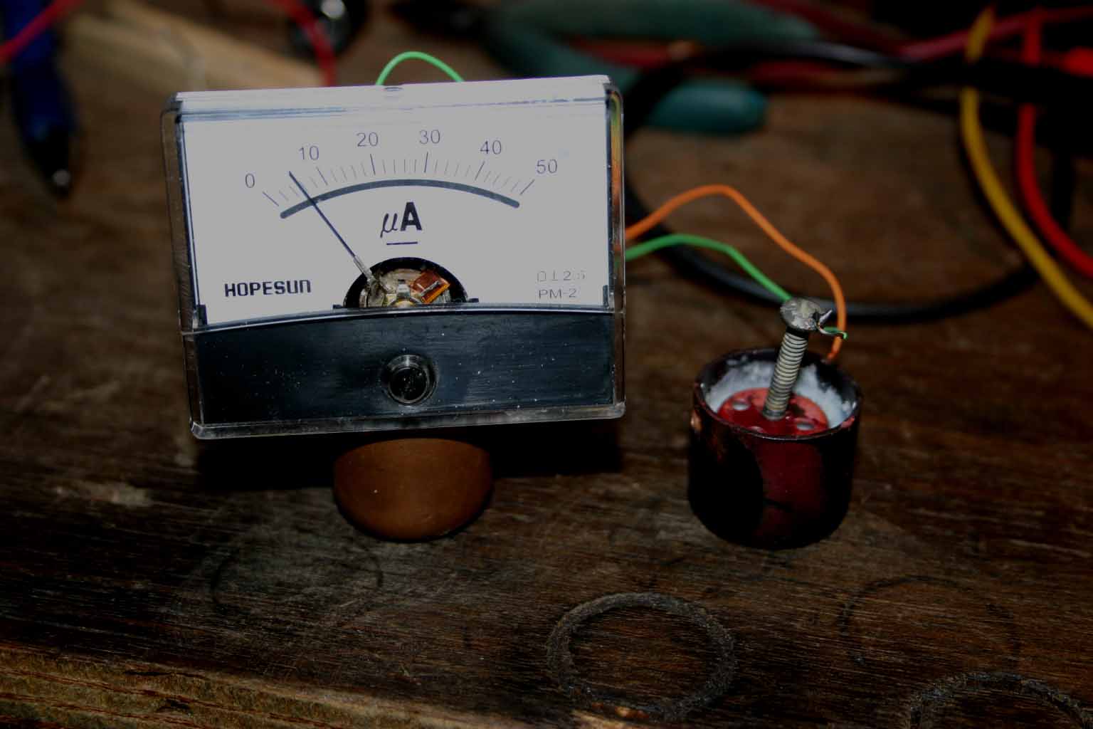

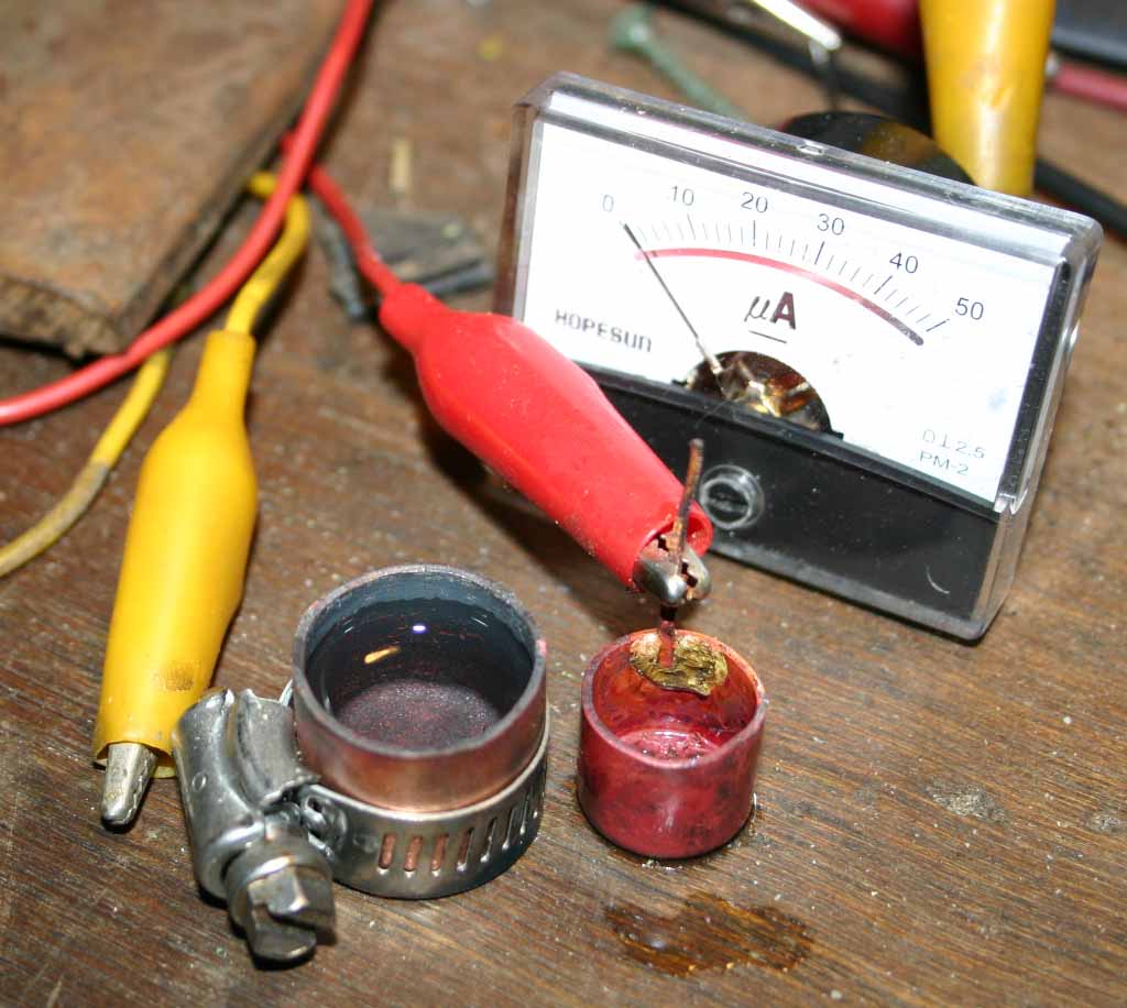

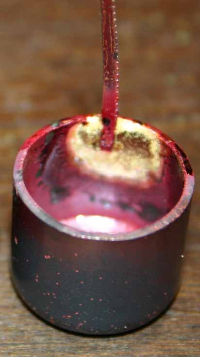

                • Copper-Copper Cell; wet and dry
                  Hi group,
                  Taking advice from John Bedini. I managed to form a thin black oxide layer on copper and on another piece of copper the red oxide. Then i pasted them into a Epsom and Rochelle salt cell. The cell after a few weeks only output is that of the ambient heat and light in the room. If i shine light into the cell the power can double and if i heat the cell lightly i can triple or 6x it. I haven't pushed it to far on the heat side as i don't want the salts to melt and the cell reset. The cell can also be charged with low voltage from a near dead battery and it will hold for some time a current above the ambient heat level of output. Like a cap of sorts. Freezing it to -38f left the cell output at zero, BUT it would still produce power if illuminated.
                  How to make a copper-copper cell; I used 2 copper pipe caps one is 1/2" the other is 3/4". on the small cap drill a few holes into the end.
                  For my salmon color P+ oxide layer. Use a pare of vice grips to hold a 3-4inch nail upright. On the nail place the 1/2 cap. Heat with blow torch until bright Orange in temp. Then quickly drop it into 3-4 inches of water. To quench it suddenly.
                  For my black oxide N layer on the inside of the larger cap (3/4) set the vice grips with nail on the bench. set the cap on the nail. Heat with blow torch until it just starts to uniformly turn red. Stop and let the cap cool slowly. here we want a thin layer of black oxide that's not prone to flake off.
                  Place the 3/4 black N cap on a hot plate. Fill with Epsom and r-salt mix and heat slowly.
                  When molten i inserted the smaller red cap into the 3/4 cap with .8v dc across it until it was cold.
                  If the power could be increased significantly this might work well in a solar water heater to provide power for some system part maybe a pump...
                  I brazed strip of copper to a small cap and retried the experiment in water. The exact same effect was seen. Tho, the cell was more sensitive to light using the far more transparent water. The water did not become murky and the metals and oxides were not attacked in any way i could notice. The response to heating was the same as the salty dry cell.
                  Thanks John Bedini, because of you, I made a semiconductor power cell that's easy and very repeatable. Tho very low power output, the physics is most interesting.
                  Dave

                    Hi Dave.
                    That is an excellent cell you've made there. Would you mind if I post it (both the pictures and the text) as a replication on Let's Replicate? We're just starting out and trying to give people a place to post their replications so they are not forever lost once the argument over their functionality dies.
                    Yours would be the first one on the Salt Battery/Crystal cell page if you accept.

                        Hello LetsReplicate,
                        Thanks, YES You can fix grammar and spread it far and wide its not secret. Tho, change the freezing temp to -38F and later in the sentence the out to output.
                        The nail points up in both P and N fabrication.
                        Making connection to the outer cap. Use a grinder or wire wheel to grind down the outside diameter oxide, back to bare copper. Then solder or use a hose clamp to make the connection.
                        The Wet cells worked best. Because they did not slowly degrade like the Epsoms and Rochell salts cell. They slowly stopped working for me in this application. The wet cells just had to be constantly topped off with water because of evaporation. Which could be fixed by enclosure.
                        I used absopure steam distilled drinking water. PH 7.8-8.0
                        I used simple propane torch for heating the copper caps.
                        I used Oxy-Propane and hi temp braze. To connect the copper electrodes together for the wet cell.
                        If anyone can improve on this please LET ME KNOW.
                        I haven't tried Ibpointless2 mix in one of these that may do it.
                        Dave
