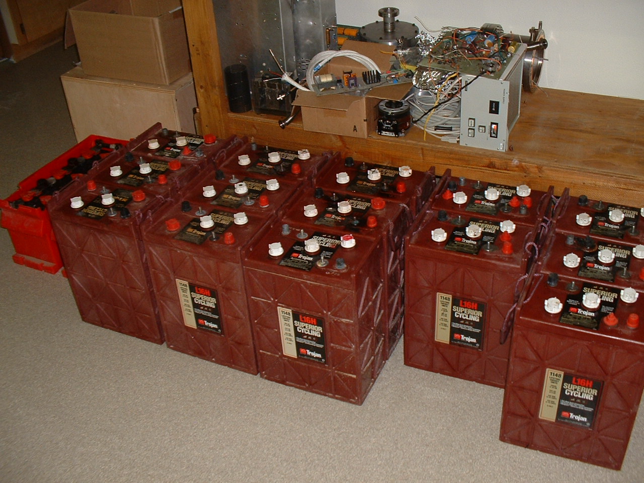

    Work has been kicking my butt for the last two weeks so I haven't accomplished much with my build. I did manage to wind the two side coils and install the core in the center coil and order parts. I've attached a picture of my wheel (Yes that's a Amish buggy wheel), coils, magnets, magnet holders and a special 12V generator I'm going to use as load.
    The big news is that I was able to scrounge 14 good Trojan deep cycle L16 batteries from the local solar power folks. They are 6V batteries so I have enough to make up two 36V battery banks with 2 batteries as spares. Each battery has a sticker saying 450AH@20hrs. I may need a bigger wheel!

      Ron,
      Looks like you are making some head way!
      Scott and I have been busy as well at work and haven't spent much time with our GT3 "Junior" recently. I'm very jealous of your battery find...that is awesome! We are really hoping to find some bigger batteries in the future. You should be very happy with those big batteries.
