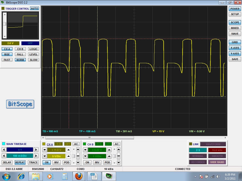

    • First stage running
      Just my machine running. runs at 22.5 RPM I can only run to 10 volts though and then it just stays on. the transistors both get quite warm. I only have the one set running right now.
      the picture is a scope shot on the collector of the MJL21193 I need to work on the timing a bit but Way Way cool!

          • Originally posted by Les_K View Post
            Les
            Hi Les,
            Great looking setup. Yay on getting it running
            What do you mean by "it just stays on"? If the transistors are getting too warm you might need to reduce the arc on the hall to drop the duty cycle a bit. Can you post a scope shot of the coil, from both the collectors?
            John K.

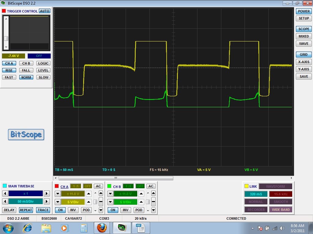

              • John K,
                Here is the scope shot of both collectors.
                MJL21194 is the green Channel B. And the yellow is the MJL21193 Channel A.
                It kicks and almost starts on its own when I turn the power on so I must be close, I think it will do great as soon as I get the other coils on.
                But I am quite sure you are right about the pulse width. I am going to adjust it.
                I probably should have used smaller magnets.
                Les
                        John K,
                        Les
                        Hi Les,
                        Sorry, I should have been clearer. Can you please post a scope shot of the scope ground on the MJL21194 collector and the scope probe on the MJL21193 collector?
                        John K.

                        • Originally posted by John_K View Post
                          Hi Les,
                          John K.
                          Here you go. I have marked the X and Y axis and if the resolution is clear enough you should be able to see freq voltage etc. in the bottom of the screen.
                          Les
                            Les
                            Hi Les,
                            That's looking better, thanks!
                            So can you see that the duty cycle is fairly high.
                            John K.
                            http://teslagenx.com
                                Thanks John, I sorta figured that out. the pdf file I posted showed my hall was on almost through the whole duty cycle of the coil.
                                In this one there is 156ms duty cycle with roughly a 100ms period and 56 ms period.
                                Given a 156ms duty cycle what would I like to see as an ideal pulse width?
                                Les
                                Hi Les,
                                My thoughts are that the duty cycle should be just long enough to saturate the core/s of the coils. I don't know or can't remember if John B ever posted what it was for his setup. It will be different for every setup as we all have different coils.
                                My experience with the Monopole SSG is to tune it for the least amount of draw current to best rate of charging. But that may not necessarily apply to the GT16-3 in some way.
                                The timing of the hall, duty cycle, placement of the coils, iron flap angle, coil gap, etc. are all variables that you'll have to experiment with. Kind of like tuning up a car I think.
                                John K.
