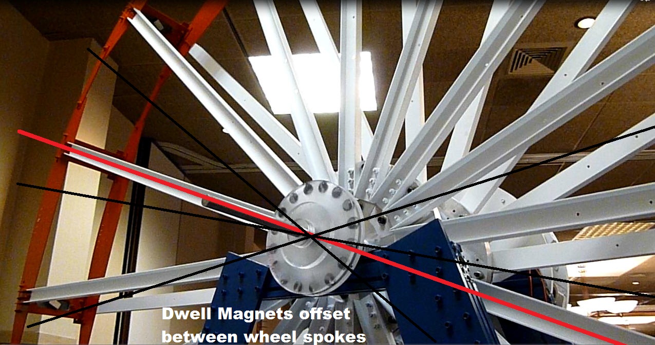

                  • Dwell Magnet Positioning
                    Matt brought this to my attention.
                    It looks like the round magnets for the hall sensor are in between the the connecting bars that run to the outer magnets .
                    http://fan1701.com/stuff/Bedini/Swit...wheel_FULL.jpg.
                    Has anybody got a better photo so that we can confirm this?
                    If it is like that and the hall is mounted in between two timing magnets while the wheel is stationary, does it mean that the 3 coils will fire in the axact position as Jeremy illustrated?
                    Also in this drawing the slave coils could be wired to atract. Not sure yet.
                    Hi Vissie,
                    I did here John B. say the dwell timing magnets were positioned between the wheel spokes.
                    But it looks like the magnets are not exactly between the spokes, just a bit offset.
                    Photos to confirm
                    Also, I remember the Hall positioned up to the inside ring of magnets as indicated in the photo, you can see it blurred through the acrylic directly above the black timing mark.
                    p.s. I believe the Dwell Magnets are for the re-gauging coils and magnets located on the hub not the large coils.
                    Merry Christmas, Mike
Name:	Dwell Magnets Relative to Wheel Spokes End View.jpg
ID:	449950Click image for larger version
Name:	Dwell Magnets Relative to Wheel Spokes End View 2.jpg
ID:	449949Click image for larger version
Name:	Dwell Magnets Relative to Wheel Spokes Side View.jpg
ID:	449951Click image for larger version
Name:	Hall Sensor Location.jpg
