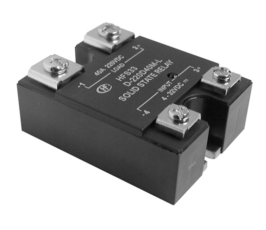

      • ssr
        im still learning this format
        two pics
        Douglas Randall Solid State Relay Model D12A 3-32 vdc input 120-v 12 amp cont. | eBay
        so give me some time to learn all the tricks
        guy b
        • Originally posted by John_Bedini View Post
          Brent,
          I'm talking about making a solid state relay for the switching.
          The Fet would get around the problems with the SCR.Mathew Jones shows the circuit a few pages back, but that solid state relay is costly so we could make that with the opto and the regulator for the gate voltage and the resistor to pull the gate off. The way around his circuit for timing is a SIDAC at 40 to 60 volts to fire the opto when the capacitor reaches the correct voltage. that is the switch I'm working on. NTE makes that part NTE6415. The higher the voltage the better, then the battery will charge fast that is what we want. Capacitor dump circuits must be double in voltage or very close to it.
          John B
          John,
          So when you use the term costly, did you mean energy-wise or $$-wise? At the time I assumed $$'s
          Is this why you pursued the comparator?
          Thanks,
          Patrick

                                My bad, I thought John B. is advocating not to use the relay, but to use the comparator or some other method that is not as costly?
                                My solution works nicely, the only draw back is the 2nd tranny heats up something fierce, maybe put a big heat sink on it and warm the house while I'm at it LOL.
                                so is it a k08a relay?
                                Thanks,
                                Patrick
