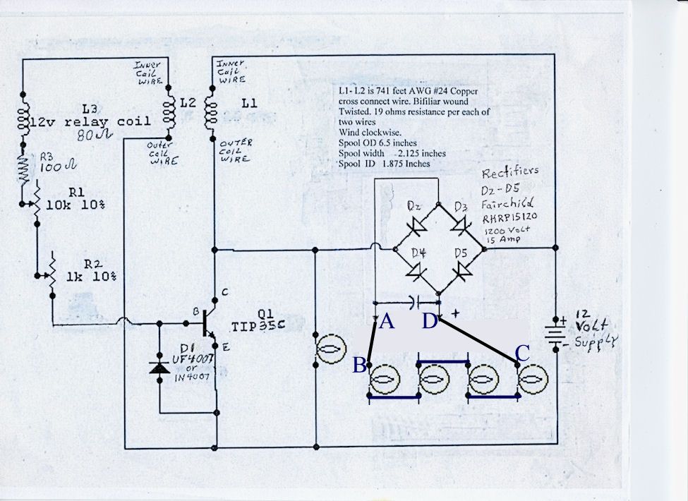

    magnetman12003, Is it possible the circuit is self resonating, thats a big coil of wire. Can you describe your circuit ? How is the source 1.5 volts stepped up by the phone charger I wonder. I may have missed it in the video what type of phone charger is that?
      The circuit I am using.
      Here is the circuit I am using. Use a inexpensive cell phone charger that houses a single AA 1.5 volt battery. I bought this one on Ebay for under $4.
      Dont power the circuit with 12 volts as shown. Hook up the cell phone charger to power the circuit.
      I also forgot to mark the NEON LAMP located just to the right of the transistor in the circuit. It should be a NEON B7A lamp. The other 4 lamps are 1 watt rated 120 volt night lite LED lamp bulbs They will lite with DC at lower voltage as seen in the video.
      Use a very large mfd capacitor in the rectifier circuit output. I used a 330 mfd 450 volt rated cap.
      Planning to double that later. Buy a hi voltage rated one and you wont go wrong.

        But the secret is in the phone charger or in the circuit?
        Could the circuit be powered by any other mean?
          You asked a very good question. Further experimenting with this setup might produce an answer.
          Tom
