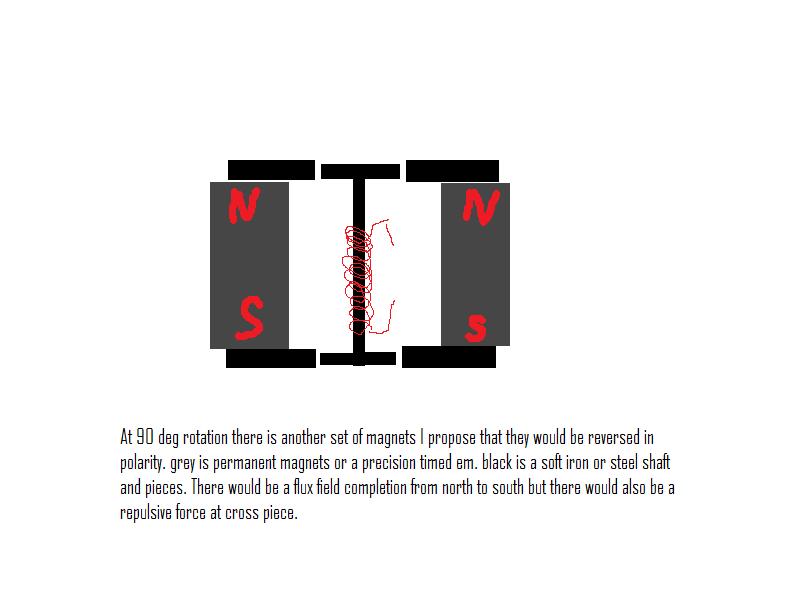

        It looks to me that the g-field prototype had a shaft mounted coil with the flux path going through the axle which means that the magnets facing opposite each other were stacked the same way. and it would work kinds of like the notch gate motor: the opposing magnetic fields would crash in the middle and curve upwards/downwards the opposing magnetic fields should create a repulsion effect straight across and the attraction of the lentz drag should be over come.
        Just my two cents, but let me know if yall have found otherwise about that generator.
        • #34
          By saying:"that the magnets facing opposite each other were stacked the same way." do you mean that the same poles, say north are facing the coil on each side?

            • #36
              Yes both stacks of magnets are north to the same end. we know from Bedini's website that he experimented with both bucking fields and flux gates. this would seemingly work.

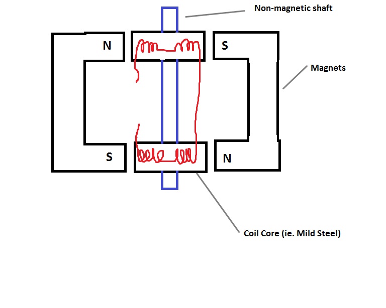

                Hi Redeagle,
                The coil is not mounted on the shaft in the way you depicted. It is actualy 4 seperate coils connected in series. In the EFTV10 dvd Bedini explains how it's all setup. I have attached a drawing worthy of the louvre below.
                Bedini states that the coils share common cores (2 coils per core) and that if you want to improve the performance of the device, the coils should be wound trifilar and paralleled. ie, each coils three strands are in parallel and then the four coils are connected in series. The output then goes to a full bridge rectifier and then on to wherever you need it to go.
                Hope this helps.
                Steve.

                • #38
                  Thanks Steve! I blame in on low res pics on the net. Can't distinguish the copper color on the shaft from a coil or something else I haven't seen the dvd yet. Can't get anyone to split it with me and don't really wanna pay 30 bucks. I'm sure i'll break down and buy it one day. so what about the magnets then. Does Bedini explain why he only uses the four stacks rather than 6 so that the flux will consistantly alternate nsnsns?
                    Hi Red
                    The copper on the shaft is the sliprings that the brushes contact. As far as the magnets go, he doesn't explain why he has them in that setup. He does say that with the two pairs he gets double the output, but as you mentioned three pairs would seem better. I did notice the drill holes on the two endplates (top and bottom) are drilled in a hexagonal pattern, suggesting that he could set the magnets up that way if he wanted to. The device I am building will have three magnet pairs so I guess I'll find out what the difference is sooner or later.
                    Steve
