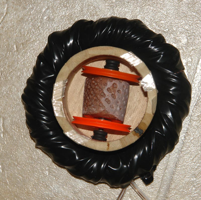

          I spun the 1" neo up in a dish, then transfered it to to the inside of the upright Spiral Knot whre it eploded in a burst of acceleration. This is the first time I got a non bearing spinner up inside the Knot. Watch out folks, this combination has limitless potential! I need to order some spheres, and see what kind of speed this can produce. "Lidmotor's Maggie" is spinning a sphere. I think the Spral Knot is powerful enough to levitate a spinning sphere.

            • Spiral coil.
              @Rave154begin with
              To start off, I use the Radio Shack 24 gauge 2 conductor 75 foot roll. This costs about $6.95. The Spiral Coil starts and ends in the same place. You may have to cut it to arrive there.
              You have to wind the wire onto a stick, so you can lace the toroid core. After that choose a dimension, like a large coffee mug for a 2" I.D. toroid. Leave a little to begin with , then make three or four loops to start, then begin to spiral the wire to where it feels right. Don't worry too much about neatness. This produces four wires at the end as the speaker wire's bifilar.
              Take a look at the size of the coil on the top in comparison to the objects in scale to get a general idea of the size. I had to cut about 10 or 20 feet off the skien because the hole began to grow too small. There's a close up of the coil too. You can see how the spiral looks under the tape. It's comming up and over at about a 45 degree angle. The turns are spread out more at the beginning. The brown speckeled magnet is 1" long.
