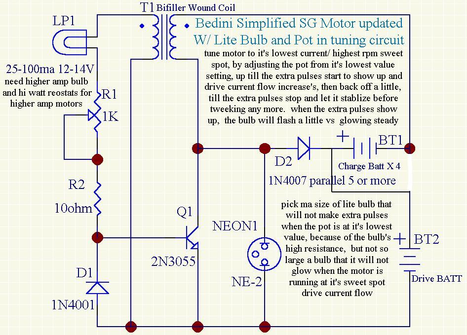

Won't work
Hi Guruji,
Well the simple answer is it will not work. If you look closely at your drawing you will realize you have the positive side of your charge battery connected to the positive side of your run battery. Now the charge battery is opposing the run battery and therefore no current can flow through to the coil to energize it. If you are trying to connect the batteries like the Ossie Callahan circuit you have to have 24 volts of battery as the run battery to overcome the voltage in the charge battery. Look again at the Callahan circuit and you will see he has 2 batteries in series to supply 24 volts. Hope this helps.

Ossie circuit
Hi Citfta thanks for response. Yes the ossie circuit is that way postive to positive no? I am using a transformer about 16v output. Is this not enough?Originally posted by citfta View PostHi Guruji,

Is it ok the modification that I did?
