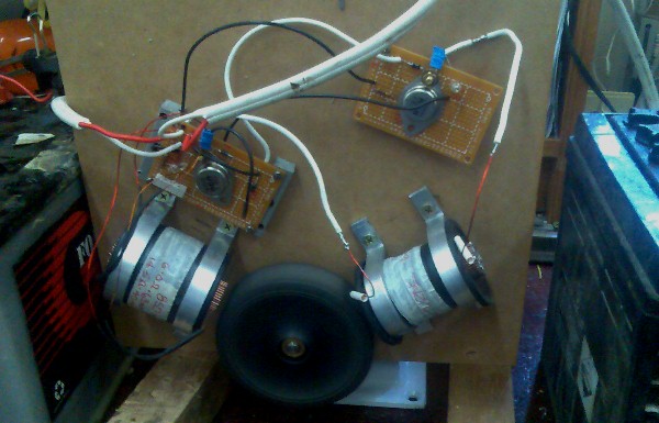

                            • My Best Friend's unit has been upgraded to a two coiler.
                              Have probably done this wrong ..... as it doesnt seem much better than a single
                              coil. The electronics havent been fully mounted yet - this pic after first getting it going.
                              Looks darn good though
                              I am struggling to get any good test data because I am bringing " Dead Car
                              Batteries back to life ".
                              Keep on losing my Primary Batt voltage [ because it has very little capacity ].
                              So probably need to persist - bring batts up to usefullness and then do comparitive testing.
                              Here's pic..........
                              [ oh its an old bakelite trolley wheel with one bearing installed, 3 x 20mm dia ceramic magnets, 850 turns - now with two lots ]
                              Glenn.
                              • Originally posted by glenn_aircooled View Post
                                The unit runs so well - I must have fluked it. If I had the coil wrong would
                                it still run and charge the battery.?
                                Glenn.
                                If you hook up a scope and see a h-wave with multiple spikes as opposed to one spike per "h", you have the coil wound for the opposite polarity. In this case it may just be easier to flip the magnets. All depends on how good your glue is.
                                It will still charge your battery, but not very well.
                                Cheers,
                                Steve
                                P.S. Your friends unit looks good. However he won't notice hardly any difference in performance if the batteries in the pic are the ones being charged. They are way to big for only 2 coils.
