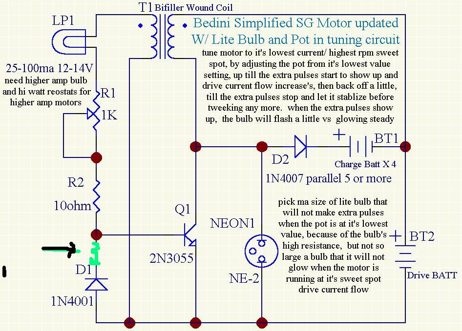

    Currently my setup as the second option. The only problem with this the transistor so easy burn (2N3055) specially when first tuning.
    Selamatg
    Ooops, you can calculate the load for the transistor, depending of AWG power coil, and turns, is possible calculate wire lenght and with the wire lenght calculate ohm of the load, applying ohm law, you can get how much amps is loading transistor. If impendance is very low, transistor get burn by excesive amp drawing...
    Other problem can be max volts to base - emitter, is possible that your trigger coil is working very very fine and can send a voltage higher than base - emitter 2n3055 can handle. But don't forget that Diode connected in (D1) Base - Emitter, is like a zener diode of 0.6 volts aprox. You can try limit current Colector with a Resistor between Coil and Colector. If you Back EMF is giving to you Back EMF very high voltage, you can reforce D2 with more diodes in series, remember that common diodes only control 1000 volts max, in series is 1000+1000 etc..

          • Originally posted by patmac View Post
            Patmac,
            Thanks for your advice.....
            I never calculate before......
            about the series diodes as you said....what about if parallel as per schematic drawing? what the purpose they suggest 5 or more in parallel?
            Hi All,
            Please advice if you have other suggestion...
            Selamatg
